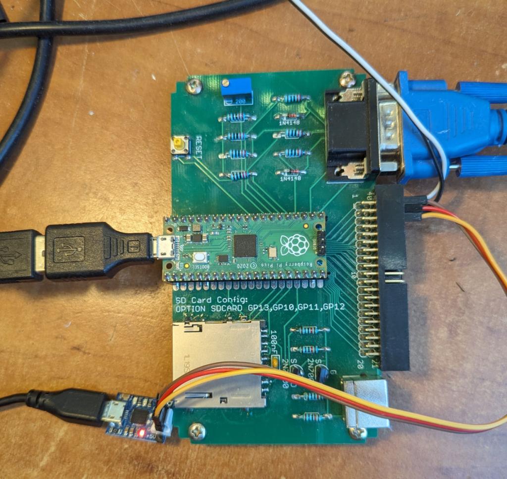

hi all,
  for those of you following the HID2CDC thread, you'll have noticed that keyboard operation is getting close to perfect, and hopefully we may have mouse support coming along at some future point.
you may have also noticed that there are a whole load of unused GPIO pins on the second pico that are not doing anything... these represent an opportunity!
i'd like to be able to make use of these unused GPIO pins to extend the I/O capabilities of the picomite VGA. but to do this nicely requires the use of out-of-band signalling between the two picos. fortunately serial over USB provides for this, in the form of 'virtual' RTS and CTS signal lines.
is anyone in the position to create two small custom function for the picomite that can:
(1) turn the CTS status line on and off,
(2) read the status of the RTS line?
i have asked Peter and Geoff about this (https://www.thebackshed.com/forum/ViewTopic.php?FID=16&TID=16596) but received an immediate no.
using these custom functions it becomes possible to send data to and receive data back from the HID2CDC without it interfering with the normal use of PRINT statements or keyboard input. everything else can be handled by a few simple functions that are held in the LIBRARY as transparent extensions to mmbasic.

because the single communications channel between the two picos carries:
1. output from PRINT statements (although we can suppress this from appearing on the VGA screen, see below),
2. keyboard input read using INKEY$ and INPUT$(..., #0),
3. commands sent to the HID2CDC instructing it to configure and control GPIO pins, as well as data directed to mass storage devices,
4. return information from the HID2CDC such as input pin status and block data from mass storage devices.
note that we can turn on/off the connection between PRINT statements and the VGA screen using OPTION lcdconsole:
Print "starting test"
Option lcdpanel noconsole
Print "invisible text"
Option lcdpanel console
Print "finishing test"
the above demonstrates sending a 'private' message from mmbasic to HID2CDC that does not display on the VGA screen. but there is no foolproof means of ensuring valid VGA output is not mistaken for a private message when received by the HID2CDC.
to send an unambiguous private message, we need to:
1. assert CTS,
2. wait for HID2CDC to respond by asserting RTS.
3. we now know that the communications channel is available for private communications.
4. when finished, reset CTS,
5. wait for RTS to reset by the HID2CDC, then carry on with out basic program.
using signalling via RTS/CTS provides the simplest, most reliable method of multiplexing the single communications channel between two very different functions. we then have a 12Mbps 2-way channel that can be used for a whole variety of tasks - the likes of off-boarding SD card, RTC, sound output, and possibly even video generation could be moved out of mmbasic. the end result would be a faster and more deterministic picomite.

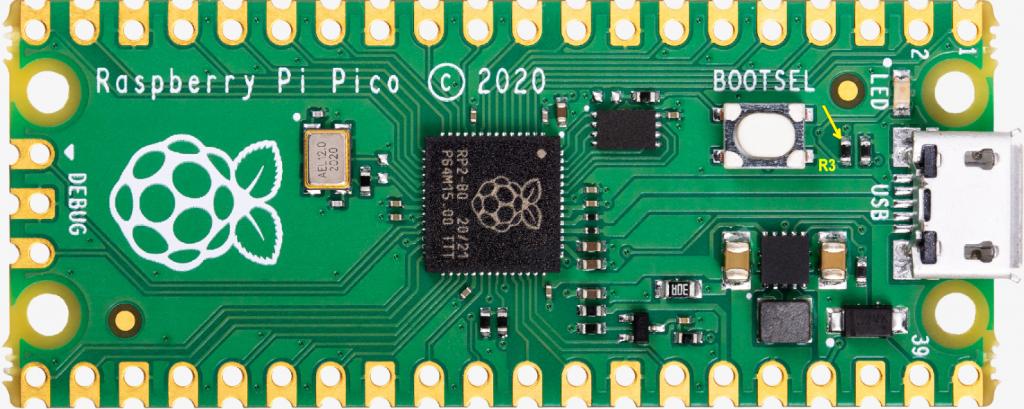

You realize that it's possible to re-purpose TP5 (the Heartbeat LED output) as an extra GP pin, don't you? It produces about 2V when set high as it's directly across the green LED. Best used to turn a NPN transistor on and off, giving an inverted output. Useful if you are stuck for an extra pin.

i am a tad confused here. i have sitting on my desk a picomite VGA attached to a VGA screen and a USB hub. attached to the hub is also a USB keyboard. a HID2CDC is attached to the host connector on the hub and routes keypresses to the picomite VGA via the USB CDC interface.
with this, what i type at the keyboard appears on the VGA screen. a program that i type in using the USB keyboard and mmbasic editor and uses PRINT statements displays output on the VGA screen. i haven't got as far as using any graphics commands, but i expect them to freely mix with PRINT statements, with the proviso that if a print statement causes the screen to scroll then any graphics on screen at that time will also scroll.
i presume there is some way to adjust the position on the screen where a PRINT statement places text output? something like gotoxy(x, y) or print @x,y?
(just went away and checked:
text 200, 200, ""
print "hello world ";
input a$
the above seems to work more-or-less correctly, the text appears in the middle of the screen and the cursor for the input is just to the right of the message)
Mixtel90, what you seem to be describing is an archaic concept from the early days of computers, where text I/O was via a terminal, and graphics output would appear on a separate screen, often generated with analog voltages applied to X and Y plates within the CRT:
it this what everyone on here expects of a picomite VGA?! is this how you all use it??? please, no offense intended, i just had never imagined the picomite VGA being used like this, always thinking of it more as a re-imagining of a 1980's home computer. i'd never seriously considered anyone would use it tethered to a PC running a terminal emulator.

  Mixtel90 said  You realize that it's possible to re-purpose TP5 (the Heartbeat LED output) as an extra GP pin, don't you? It produces about 2V when set high as it's directly across the green LED. Best used to turn a NPN transistor on and off, giving an inverted output. Useful if you are stuck for an extra pin.
Of course you could always solder to the point shown by the yellow arrow below and get a full 0-3.3V swing on GP25. If you removed the Resistor labelled R3 you could also use it as an input, assuming MMBasic allows GP25 to be an input.
By Removing R3 it will expose a small pad to solder onto and allow `clean' access to GP25.
Mick (The big one)
EDIT***
Of course by removing R3 the LED will never illuminate.
Mik
Edited 2024-01-26 15:26 by bigmik

  Mixtel90 said  Huh... I have a job even *seeing* R3, never mind waving a soldering iron anywhere near it!
Mick (The optically challenged one)
You are speaking to the converted here, I have about 6 pairs of glasses lying around, each has different uses. My favourite is an Optician quality that is somewhere between the cheap +3 and +4 that I use for soldering. It took a lot of convincing ‘Specsavers’ to do them as they were adamant that “that is NOT what you want/need old fella”
But seriously removing R3 is not that difficult and I would use single strand ‘wirewrap’ to solder to the pad and glue it to the pcb for strain relief.
All that said, I have not done so.
It was posted that it IS possible not that it is mandatory to do so.
Mick (The big one)
