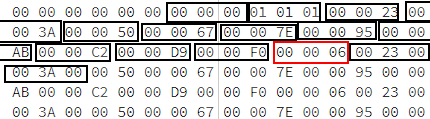

But armed with the knowledge you provided, I looked at a Hex dump of the file and we might have two separate issues.
The first is a potential corruption of the 24-bit image file during save.
The first two numbers are mapped correctly (0,0,0) and (1,1,1). Then it goes into the loop and the next sequence of 10 numbers should be (0,0,0x1F), (0,0,0x33) (0,0,0x47) (0,0,0x58) (0,0,0x6F) (0,0,0x83) (0,0,0x97) (0,0,0xAB) (0,0,0xBF) (0,0,0xD3) (0,0,0xE7)
(In decimal those number are: 31,51,71,91,111,131,151,171,191,211,231)
That first number 0x1F is 4 more than it should be in the raw file dump. Then next one is 7 more. The next is 9 more, and the gap keeps getting larger until we get to the final number (0,0,0xE7) which looks like it has overflowed 255 and reverted to 6.
That might account for why the image won't load (uncorrupted) into Paint.Net. But also, I don't want to jump to conclusions - does anyone have any decent knowledge of the BMP file format that might confirm or refute my hypothesis? Or (more likely) is there a flaw in my program logic and I'm miscalculating the numbers?
And the second issue is then that we appear to have no way of storing an image with MAP-ed colours. I now realise that this is not a problem. I can write my own file save and load routine for that. The CMM2 can write a full screen of data pixel by pixel in about 600ms, so it's easily fast enough to rebuild an image from file. Especially given that was just using the PIXEL command. If I loaded an array of bytes and dumped it directly into the memory locations I'm sure it would be much faster. I really just needed a sanity check to see if I wasn't missing something fundamental (which I might still be).
I might even still roll my own file load now that I think about it. It would allow me to intersperse the loading with an animated file screen (so load a bit of data for 100ms, colour swap the title screen to make something move, load the next 100ms of data, animate and so forth). It could be quite a cool effect.

Posts: 6538
Posted: 04:51am 04 Feb 2024
When you use 8 bit modes the colours are mapped to 3bit,3bit,2bit so what you read may not be what you wrote.

Posted: 05:53am 04 Feb 2024
  TassyJim said  When you use 8 bit modes the colours are mapped to 3bit,3bit,2bit so what you read may not be what you wrote.
Thanks, that is an excellent point, and I thought that was the case as well, but a 2 bit blue would only give us four possible values for the blue component, yet the above file has 13 discreet values, so I'm not sure that's it.

Another quick update. When saving the bitmap from GIMP it jams a bunch of extra data in there which messes up the previous load logic. This version is more refined and can handle different size headers.

Posts: 3289
Posted: 06:26am 06 Feb 2024
Gimp has possibly added it's own 256 word palette.
From memory the header has a word that tells at what byte number the bitmap data starts. If you can find that the changed header length won't matter.
From the "BMP File Format" link it's at offset &h000A.
