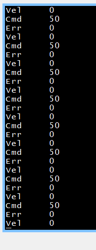

Well I wasn't anticipating (or needing) such fantastic performance.
This has to be a world's first
High performance closed-loop Position and Velocity control under interpreted Basic
ArmMite H7
$5 LMD18200 H-Bridge module
DC Motor with HEDS encoder. 500 line = 2000 quadrature counts/rev
LS7366 SPI Quadrature decoder/counter
ArmMite Basic
Full Proportional-Integral-Derivative (PID) filter
Integral limit
Velocity Feed-Forward
Acceleration Feed-Forward
Torque Limiting
Output Offset (to compensate for external influences, such as gravity)
PID Loop rate: Currently 1ms (industry standard) but could easily handle 500us

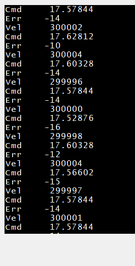

No "Sync" that we have in PicoMite Basic and so I profiled (surprisingly good):
Velocity regulation is amazing, considering the simple H-Bridge:
Command Velocity: 300,000 quad cts/sec = 150 revs/sec (2000 cts/rev) = 9000RPM
Cmd: The PWM%. This is "Antiphase PWM", meaning that 50% duty-cycle is zero output to the motor.
Err: Command_Position - Actual_Position. Velocity Feed-Forward (VFF) applied.
Vel: Actual motor velocity in quadrature counts/sec.
Steady state maintains zero position error. Force the motor shaft out of position or turn it with motor power (32V DC) off and it will jump right back.
Now to implement Trapezoidal and S-curve velocity profiling, master/slave gearing and interpolation with other units
This thing has all kinds of possibilities.

Hi Volhout,
The PWM is running at 18KHz and runs in the loop. However, it is only temporary for desktop testing/development. The DACs will take-over, eventually, as I drive a motor-command of +/- 10V. The H7 has 12bit DACS which is just perfect
I have to say that I am quite impressed with this crude setup, totally stable. I have to grab the motor shaft to know if the loop is running
I started-out with SETTICK but it's limited to a resolution of 1ms. This 1KHz is more than adequate for the application (the consensus is 10 X the bandwidth of the machine) but my code execution time is currently < 200us. I have a bit more to add but I don't see it going past 300us. So now I have the option of running the loop at 2KHz.
