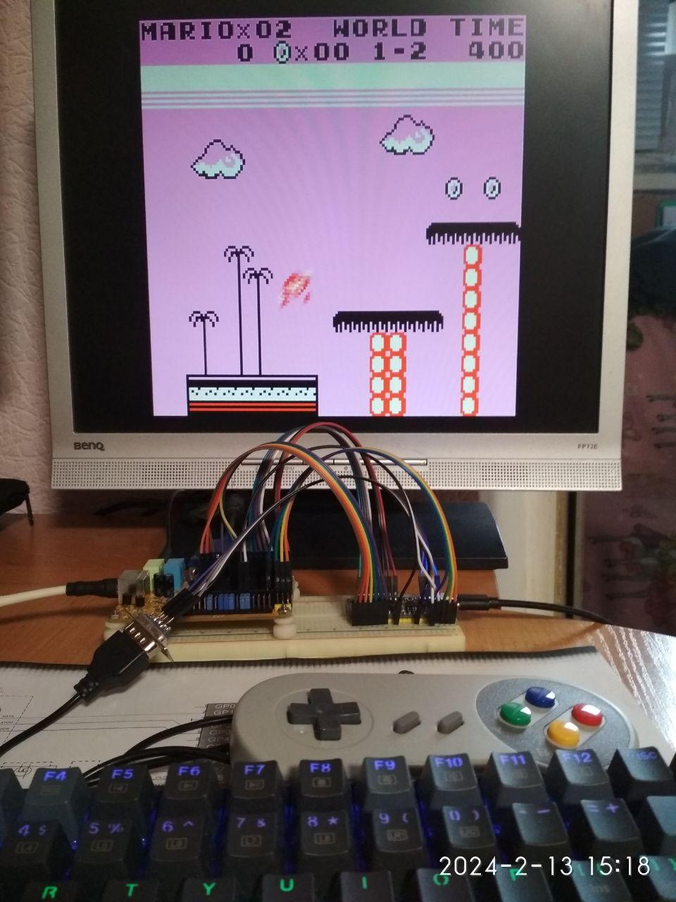

Adapted the pico-gameboy firmware of the GameBoy emulator for the PicoMiteVGA board
https://github.com/xrip/pico-gameboy
On the SD card, create a folder GB: in the root, put the ROM (*.gb *.gbc) files there.
Controls:  PS/2 Keyboard & NES Gamepad
UP, DOWN, LEFT, RIGHT - Arrow keys
A Button - Z key
B Button - X key
START - Enter key
SELECT - Backspace key
SELECT+START in game menu
The NES gamepad is connected like the PicoGAME VGA board
        NES_GPIO_CLK=  GP3
        NES_GPIO_LAT=  GP2
        NES_GPIO_DATA= GP1
Gamepad power supply is 3.3 V
Mono Audio on GP22
GameBoy_for_PicoMiteVGA.zip

  cosmic frog said  Can't seem to get this to work on my PicoMiteVGA.
No output to the monitor and the pico just stays in BOOTSEL mode.
What version of PicoMiteVGA board do you have?
(Ver.1.0 PWM or Ver.1.1 I2S )
Unfortunately, I don’t have the PicoMite board itself and I ported it on a breadboard assembly (photo at the beginning)

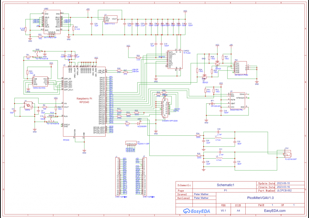

javavi
Joined: 01/10/2023
Location: Ukraine
Posts: 642
Posted: 05:47pm 14 Feb 2024
  cosmic frog said
Hi, it's just a PicoMiteVGA. It's built on a piece of proto board. I wasn't aware there was a special board.
Is there a schematic for this board so I could build it myself?
PicoMiteVGA10_scheme.pdf

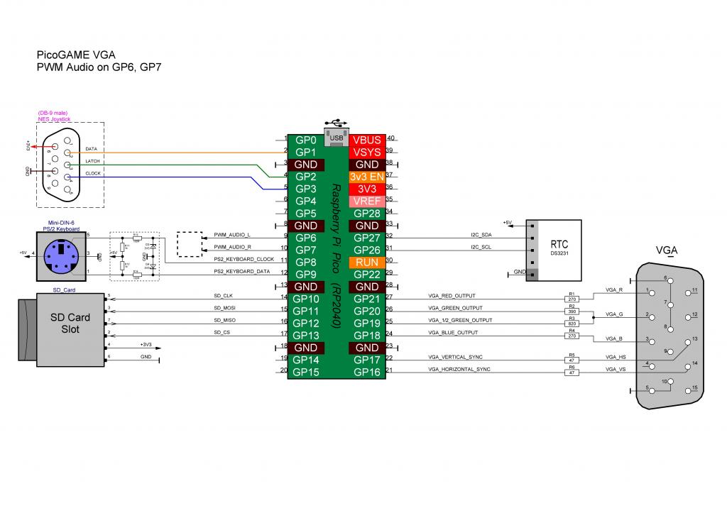

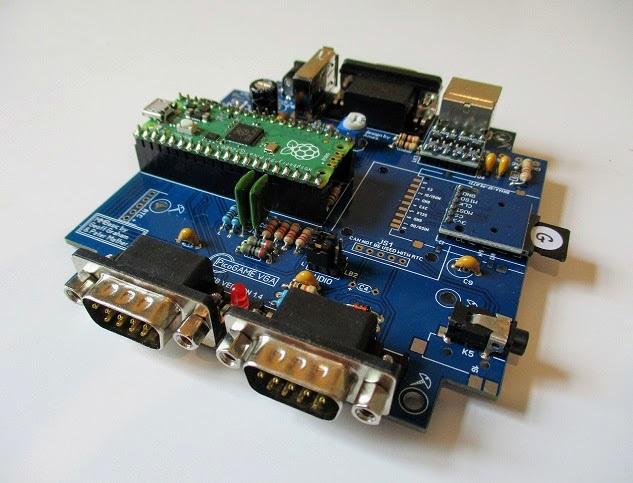

Posts: 9383
Posted: 09:16pm 14 Feb 2024
I sort of recognise that board. :)
PicoGAME has GP0, GP1, GP2 and GP3 on Port A for the joystick/controller connections.
Edited 2024-02-15 07:17 by Mixtel90

Joined: 01/10/2023
Location: Ukraine
Posts: 642
Posted: 04:06am 15 Feb 2024
  Mixtel90 said  I sort of recognise that board. :)
Hi Mick,
I did an assembly for PicoGAME VGA using a NES gamepad connected to Port A, which uses GPIO ports for its operation: GP1, GP2, GP3
PWM sound on ports GP6, GP7
If you or anyone else needs it, I can change the connection as you please.
And, although the RTS is shown in this diagram, it is not used for the GameBoy emulator.
Best regards to everyone,
Java
