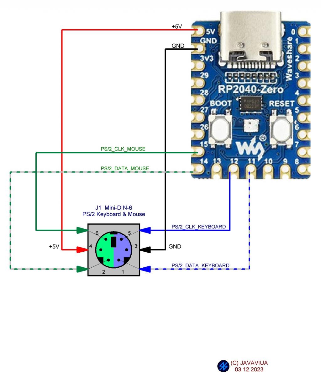

For my PicoMite I use a USB keyboard connected via a homemade adapter USB-PS/2 adapter made from RP2040-Zero
It is connected directly without unnecessary details :))
It also allows you to simultaneously convert a USB mouse to PS/2
https://github.com/No0ne/ps2x2pico

Using that circuit with no level shifter is adventurous. You will be feeding 5 volt signals into the pico. Not good.
The adapters on Amazon and others are meant for keyboards that can automatically switch between USB and PS2, there is no converter inside them little adapter plug. Keyboards that can do that often come with an adapter plug but they seem to be getting harder to find.

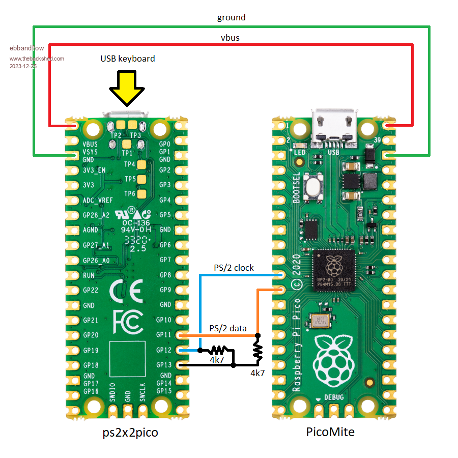

No, I don't believe so but the github for the ps2x2pico here https://github.com/No0ne/ps2x2pico shows how to solder a little level shifter board directly to a pico. I have built and used the circuit described in the GITHUB and it works well.
If you're not using a level shifting circuit on the picomite VGA side, then level shifting is not required and I have had success with the ps2x2pico firmware and this circuit:

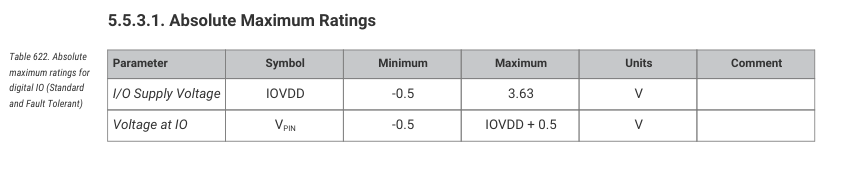

From the rp2040-datasheet:
From that table if you are running the Pico at 3.3v then the maximum voltage on an I/O pin allowed is 3.3v + 0.5v or 3.8v.

Its not a voltage divider they are pulldowns controlled by the ps2x2pico's gp13. This is the circuit without level shifting.

Thank you, I don't see any reference to that circuit on the Github site but I do see plenty of references to level shifters. I cannot see how it adds anything worthwhile to the circuit. It will not reduce the 5v logic levels to safe limits.
The output impedance of the keyboard's data line may be high enough to limit the current to a safe level for the Pico's input protection to handle, but that will depend on the individual keyboard and your luck.

Posts: 6642
Posted: 04:22am 18 Feb 2024
Pico to pico is both 3.3V so no level shift needed.
It is only when you connect 'real' PS/2 devices or hosts that are expecting real PS/2 levels that the problem is present.

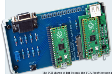

The first circuit plugs into the PS2 connector on the PicoVGA (I Believe) which does use 5v levels but...
I should give while I'm only so far behind.
Which circuit do you want to use?
The first one shows something which is separate and connects between the keyboard and the PicoVGA. The level shifter in the PicoVGA uses 10k pullup resistors so that should limit any input current to safe levels so a level shifter should not be needed.
It could also be fitted internally without the socket and PS2 lead the same as the second one shows. This means surgery on the PicoVGA board.
The second one is meant to be fitted internally. This also means surgery on the PicoVGA board.
A third option may be to use Peter's "CMM1.5" firmware which means you can plug the keyboard into the Pico's USB socket via a USB A to C adapter. I have not followed it closely enough to know if this is viable.
