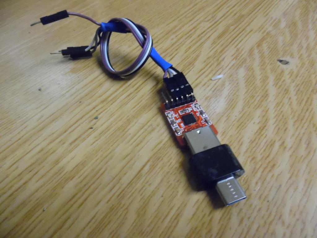

Posts: 8911
Posted: 05:15pm 18 Feb 2024
These, Stan.
Posts: 2807
Posted: 05:41pm 18 Feb 2024
Thanks Mick, more sensible for vero.
