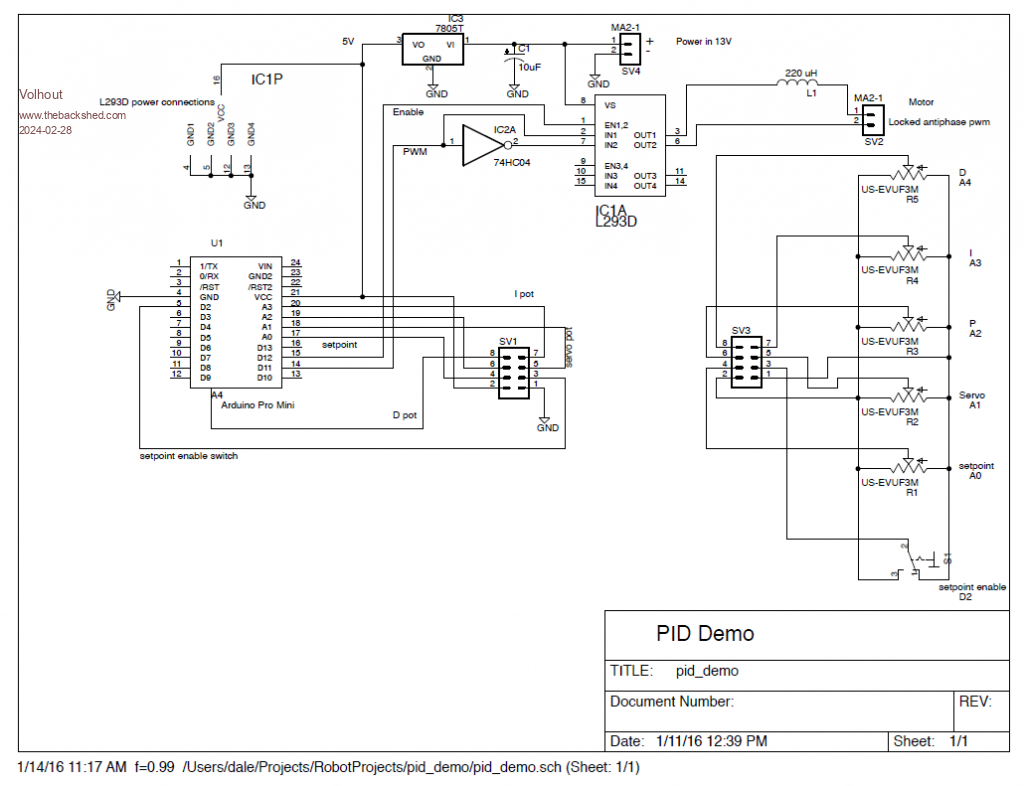

I need to build a rig like this. I come across sooo many who pretend to understand PID but who are actually clueless
Posts: 5931
Posted: 07:55am 28 Feb 2024
Great tutorial !!
All design files are included, so go ahead, and build it.
Edited 2024-02-28 18:04 by Volhout

Oh, I already have something far superior, running on the ARMmite-H7 (real encoder, no pot) including acceleration feed-forward, velocity feed-forward, torque-limiting, motor-offsets, etc.
No, I was referring to the mechanical rig. Much easier than trying to train people on an actual machine.
