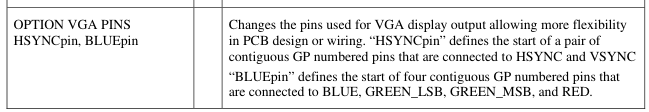

I believe Peter has made the VGA output pins configurable. Not sure where to find it at the moment.
Bill
Turbo46
Joined: 24/12/2017
Posts: 1693
Posted: 05:55am 02 Mar 2024
From the manual:
Don't know if it affects that board though.

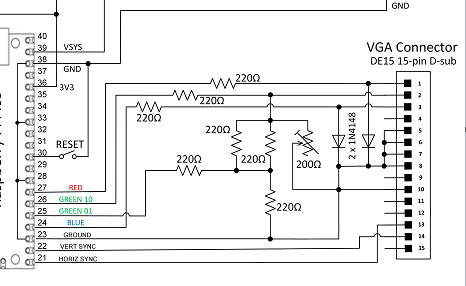

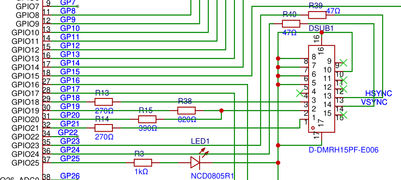

   if you lift R39 and R40 you can probably wire them across to the standard pins available on the 40-pin connector. then disconnect the audio and wire that to the standard audio pins - are there standard pins for audio?
rob   :-)
Footnote added 2024-03-02 18:03 by robert.rozee
remove R34 and R35 to reroute the audio. schematic is here:
https://github.com/UKTailwind/PicoMiteVGAUSB/blob/main/Schematic.pdf

On Peter's new PCB he has used GPIO that is not normally available on the Pico.
He used GP23 & GP24 for Hsync and Vsync, neither is available on a standard Pico.
Peter has released different version Firmware for his board. Off hand, I am not sure where to find the latest version for those boards.
Using the standard firmware you need to set the pins used for the VGA pins.
Look up OPTION VGA PINS HSYNCpin, BLUEpin
I believe the correct option would be
OPTION VGA PINS GP23, GP18

Peter - are you saying that the picomite VGA USB firmware you are creating will not run out-of-the-box on any of the standard picomite boot-to-basic PCB's as, for example, published in Silicon Chip Magazine?
it makes absolutely no sense to deviate from the existing GP16-17, GP18-21 usage for VGA that has been used by everyone since the picomite VGA began.

The USB Edition 1.0 that I have is fine on VGA.
OPTION VGA PINS GP23, GP18 (as written on the bottom of the PCB).
