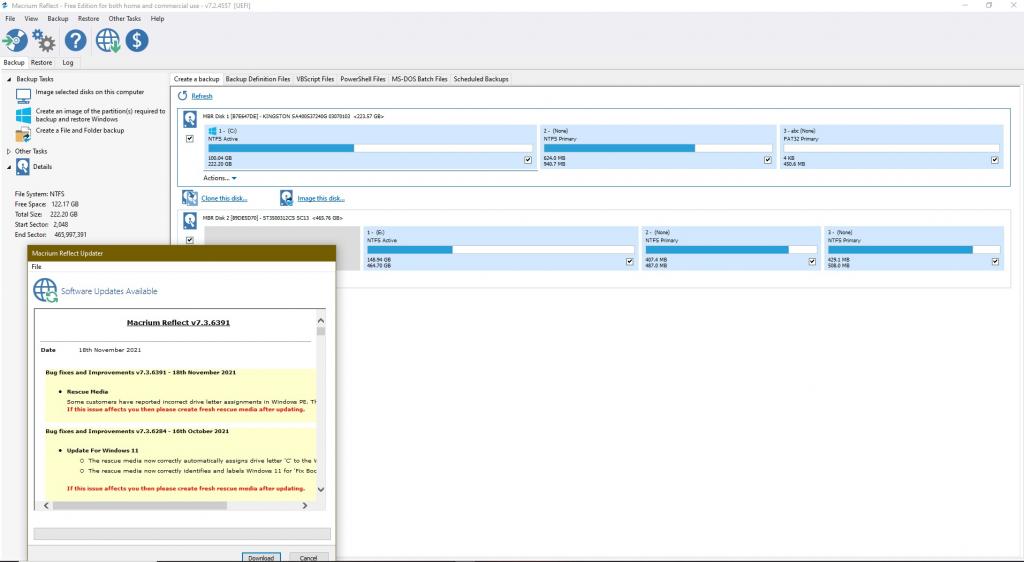

Posts: 2807
Posted: 09:26pm 05 Mar 2024
I used macrium but now said it's not free what to do , keep as is?. my version on win10
