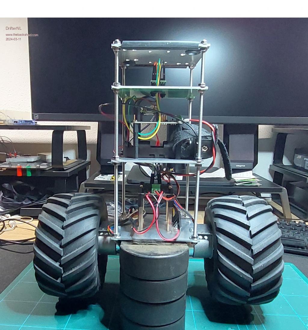

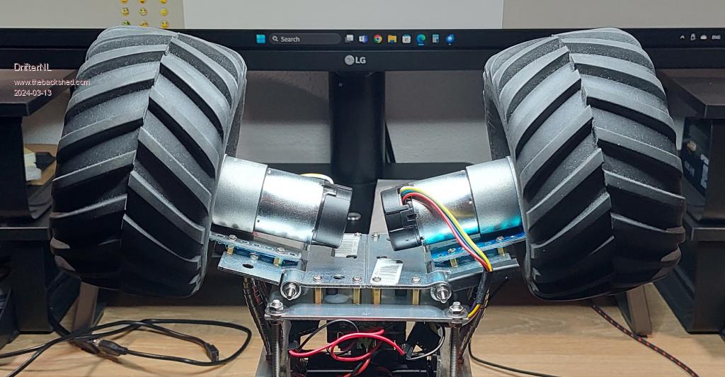

Big Wheel Balancer V2:
Controller: Pi Pico with MMBasic
Sensor CMPS12 (later changed to CMPS14) from Devantech (robot-electronics)
Motor Driver: Cytron MDD3A
Motors: Pololu #1445 (later changed to #4752)
Power: 2 (later 3) Soshine 3000 mAh Li-ion cells in series.
Monster Wheels from Amazon with 12mm hex to 6mm shaft adaptors.

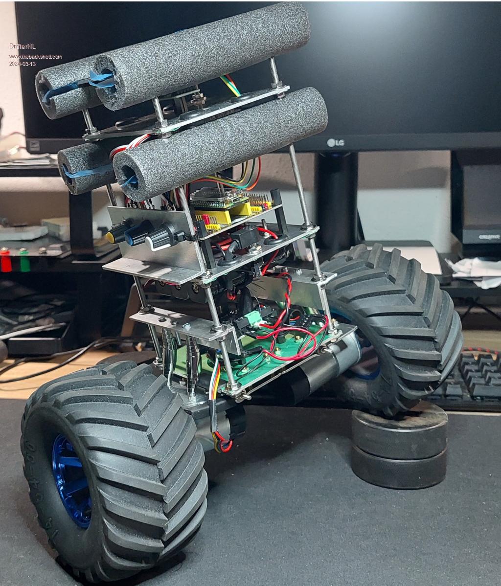

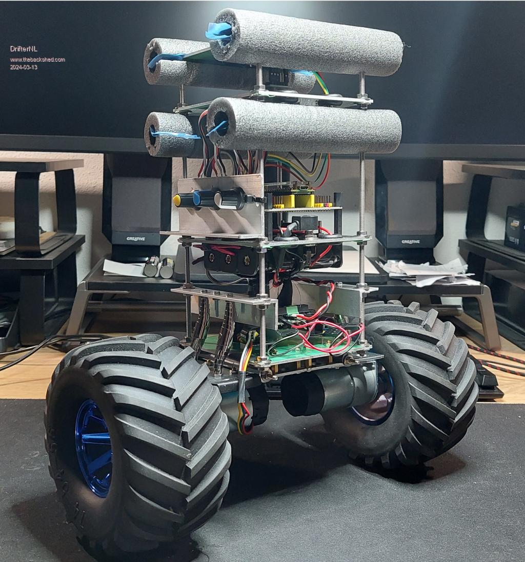

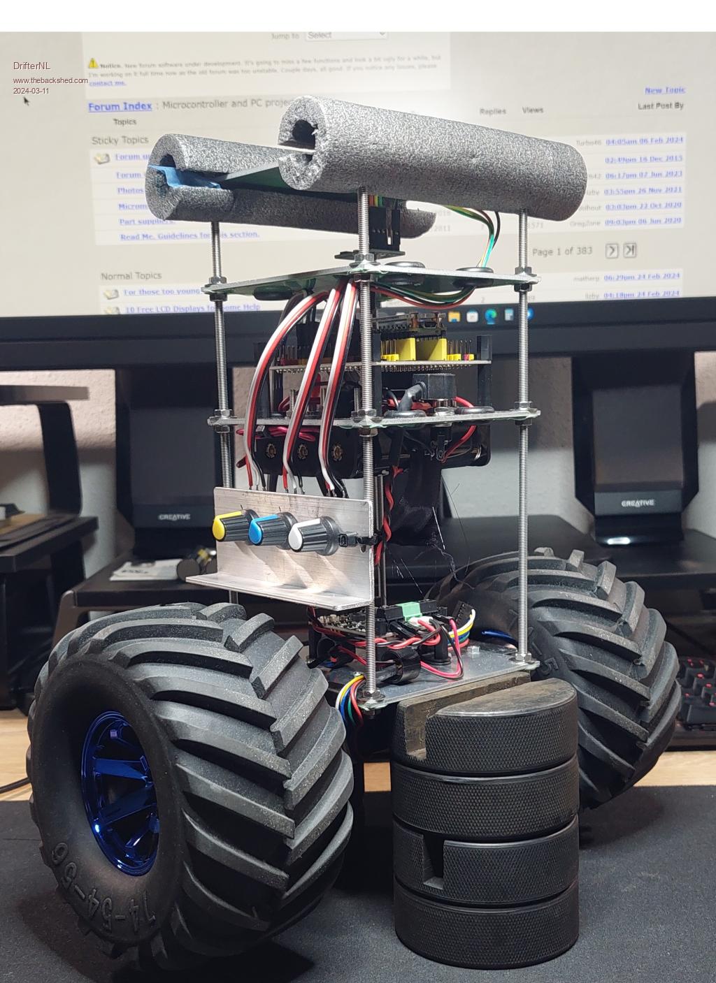

Big Wheel Balancer V3:
Sensor: CMPS14 from Devantech (robot-electronics)
Motors: Pololu #4752
Power: 3 Soshine 3000mAh Li-ion cells in series.
Changes:
Created a new power and controller section and cleaned up a lot of the wiring.
Also added 3 potentiometers to easily-er adjust the PID control.

Hi PhenixRising, DrifterNL
I see your batteries (mass) are located at the ceiling of the ground level. Is there any benefit in rasing them up a few floors ?  or will the inertia just create a slower moving robot ?
In the link you provided, his version 4 has batteries on top floor, and acceleration sensors on bottom floor.
Just curious

  Volhout said  Hi PhenixRising, DrifterNL
Just curious
That would create more of a pendulum than it already is; if anything, would be better to lower as much mass as possible. I once had an idea for these as table-servers but the payload would be the problem. Ideally, this requires cascaded PIDs and some fuzzy logic - to be adaptive.

DrifterNL
Joined: 27/09/2018
Posts: 58
Posted: 07:41am 12 Mar 2024
Hi all.
PID controllers is a new learning subject for me.
When BWB V2 was put together I was just able to get it balancing with the code I wrote.
I had heard about PID but had never really looked into it.
Searching the web I came across a Wikipedia article that had my head spinning lol -> WIKI PID
After a further search I came across an article from PARALLAX which simplified how PID works and made it very understandable -> Parallax PID
The Parallax article breaks everything down and helped me a lot to write my own code.
It took me about an hour of trying values to tune the PID, plug the usb cable in, change the values, unplug the cable, run the robot on the floor, rinse and repeat.
And yes, it tipped over many times!
Eventually I got it to a point that I could even hit / tap the robot (not too hard) and it would recover.
It was interesting watching PID do its work and how the characteristics would change even with the slightest adjustment.
The pots were eventually added so I could adjust the main values (which I got through trial and error) in small steps and not have to constantly plug in to the USB.
How high to put the weight was also a bit of trial, error and luck.
I read a few on-line posts about how high to put the weight and if I understood it correctly the higher the weight is placed the easier it is to balance but the more susceptible it is to sudden changes in direction (harder to recover), the lower the weight is placed the harder it is to balance but is less susceptible to sudden changes in direction (easier to recover).
I think I found the sweet spot for the robot.
Auto tuning PID, if even possible for my bot, is way above my pay grade.

DrifterNL
Joined: 27/09/2018
Posts: 58
Posted: 12:30am 13 Mar 2024
  PhenixRising said  I'm just delighted to see another shedder doing this type of thing. Your balancing bot should be in every high-school...What a great learning tool
Thank you
In the PID I did add a limit to the integral to prevent values getting to high (running away), this comes in handy when handeling the bot while the software is running.
Outside of the PID I also added PWM starting values for the motors due to slight differences in the motors (forward and reverse) and maybe in the components of the MDD3A motor controller.
Also the bot can turn to face a course heading by slightly adjusting its PWM values being sent to the MDD3A by using the yaw which is calculated in an CMPS14 I2C subroutine.
I also added a pitch correction value because the center point of gravity was ever so slightly off (about 1°), before this the bot tended to drive off slowly in one direction while balancing.

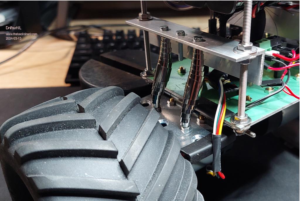

DrifterNL
Joined: 27/09/2018
Posts: 58
Posted: 12:47am 13 Mar 2024
Big Wheel Balancer V4:
Changes:
Added suspension to the bot.
The suspension is made from 2 door hinges with the pins replaced with brass tube to take out a lot of the slop, metal pcb standoffs and springs that are normally used in garden tools.

PhenixRising
Joined: 07/11/2023
Posts: 1954
Posted: 07:29am 13 Mar 2024
Hinges...Brilliant
