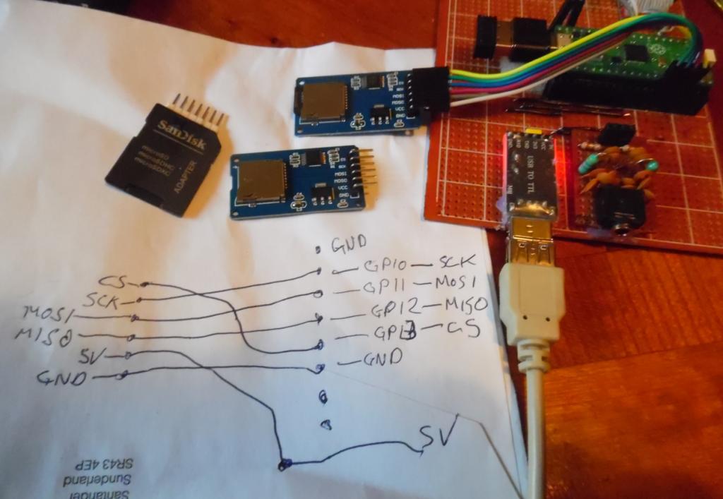

Really sorry to ask but I converted a sd card adapter to a breadboard reader and read sd card but then said "sd card removed" so bought 2 sd card readers , for arduino but logic is 3.3V, 2 for £4.80 but drive "b:" then files says no sd card.
Wiring ok. tried swapping miso/miso.. says moso on reader.
dunno if I contact seller as they may be fine.
using vga usb 005b.
PicoMiteVGA MMBasic USB Edition  5.09.00b5
OPTION AUTORUN  ON
OPTION COLOURCODE ON
OPTION KEYBOARD US
OPTION CPUSPEED (KHz) 252000
OPTION SDCARD GP13, GP10, GP11, GP12
Posts: 11512
Posted: 05:41pm 13 Mar 2024
I'm afraid those "arduino" sdcard boards never work. You want a board with no components or just a capacitor across the power lines.

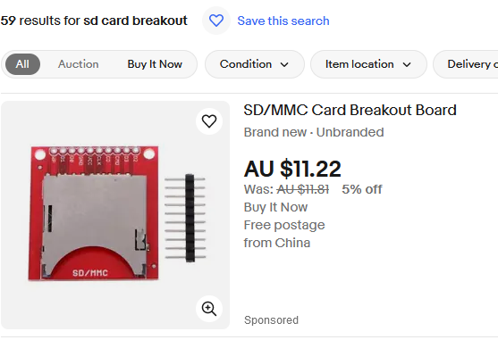

Posts: 6538
Posted: 08:33pm 13 Mar 2024
search ebay for "sd card breakout"
I ended up with a page of suitable boards with NO extra chips, just as Peter suggested.

Posts: 8911
Posted: 08:14am 14 Mar 2024
The problem with the modules (designed for 5V Arduinos) that have chips on them is that they are designed for 5V systems. All SD cards are 3V3, so there is a LDO regulator on board. Unfortunately these have a minimum input voltage of around 3V5 at best (usually higher) and often nothing comes out of them (or it's a low voltage) when powered from 3V3. Additionally there are often level shifters, which shift the 3V3 signals from the SD card up to 5V. This makes a mess of the idea of powering the module from 5V and connecting the signals directly to a Pico.
If you are *really* lucky you might find a module that will let 3V3 through the regulator (albeit unregulated) and with level shifters that work properly. In those cases the module might work, but results could be marginal if you swap SD cards.
It's far easier to get the right SD card module in the first place. :)

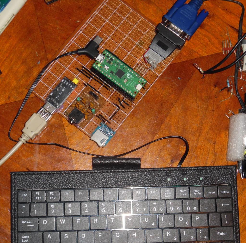

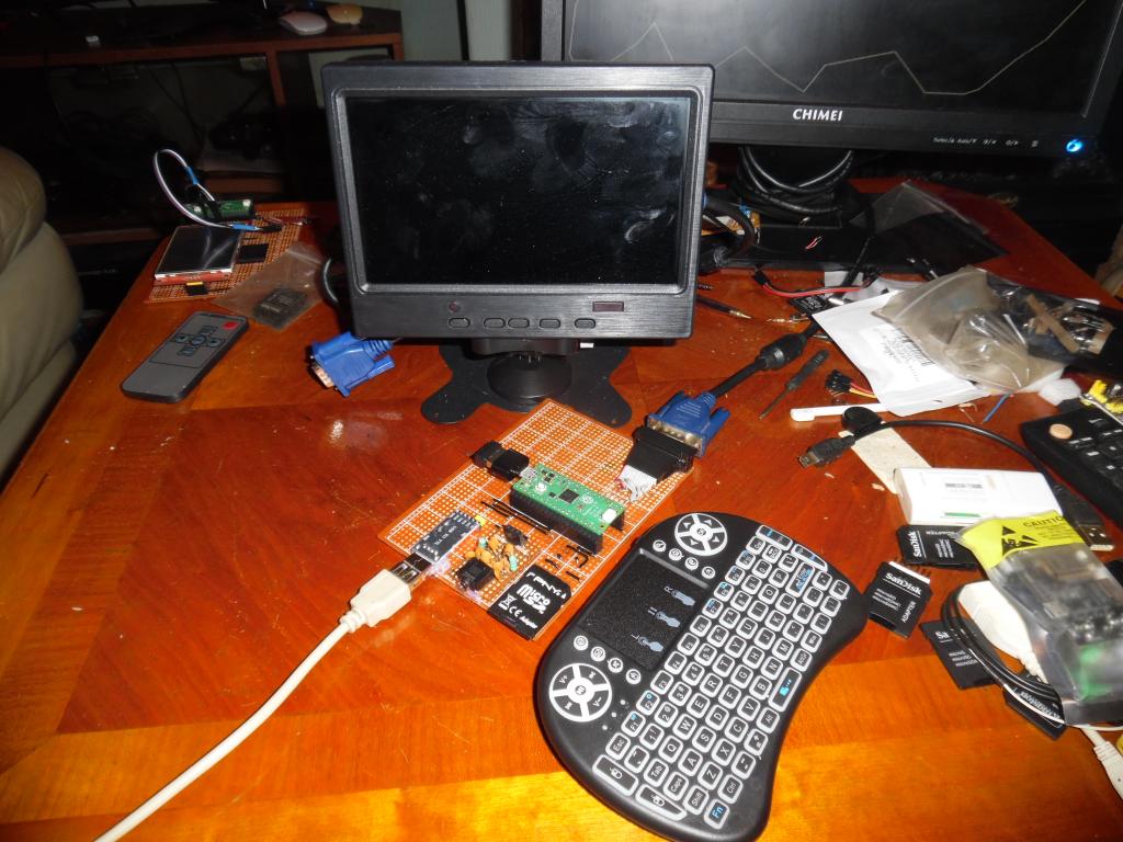

arrived today and works vga usb . thanks Mik
Posts: 2807
Posted: 08:34pm 28 Mar 2024
it's small. messed up the board with arduino sd reader, tracks cut and wiring then unsolder it all but this was ok but wiring not neat, worked first time though and so cheap I got 2.
