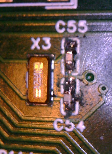

Posts: 11195
Posted: 07:48am 04 Jul 2024
Grogster has also reported some boards not starting up properly and has sent me an example to diagnose.
The issue seems to be the RTC crystal circuit.
The crystal is 12.5pf and the two load capacitors C54 and C55 are specced at 10pf
This should give 5pf for the capacitors in series and allow 7pf for the board to give a reasonable match to the crystal.
Perhaps the capacitors supplied by JLC are incorrect? I can’t measure anything that low so no way to test.
I have fixed Grogster's board by simply removing C54 and C55 so if anyone else is having a problem they could try that.
There is an alternative fix with new firmware that clocks the RTC off the main 8MHz oscillator which is more accurate and eliminates the need for the RTC crystal entirely.
HOWEVER, the oscillator doesn’t run when the power is off so the DS3231 has to be enabled to avoid time loss with this firmware.
I can post this firmware if necessary.
Posts: 9935
Posted: 01:21am 08 Jul 2024
Yes, I had three boards that would not start from my last batch.
Following Peter's advise after he played with the board I sent him, I simply removed C54 and C55 from the other two boards I had here that would not start, then they started up just fine.
Standard firmware.
I will most likely simply leave these caps off the BOM for the next batch of boards, or substitute a lower value that Peter suggested to me during our emails.
But so far three out of three boards that would not start, started just fine if you remove the two load caps, so I will probably get at least some boards made with those caps simply left off and see how we go.

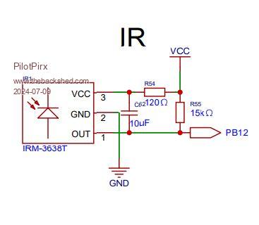

Posted: 02:44pm 08 Jul 2024
The IR receiver does not work on my board. When signals are received, they look like a capacitor charge/discharge curve. In the circuit diagram it looks like there is a 10µF capacitor on the signal output. This cannot be correct. I assume this is to buffer the supply voltage. Has anyone tested this? Is there an error in the circuit diagram?
Posts: 3148
Posted: 09:39pm 08 Jul 2024
  Quote   I assume this is to buffer the supply voltage.
Yes, remove the capacitor and solder it between pins 2 & 3 on the underside of the board.
Posts: 11195
Posted: 07:37am 10 Jul 2024
Apologies for the IR circuit bug. Attached V2.1 gerbers/BOM/PLC  and schematic
NB: I've also changed the load capacitors for the RTC crystal to 6.8pf
Gerber_PCB1_2024-07-10.zip
BOM-PLC-SCH.zip

Posts: 11195
Posted: 09:44am 24 Jul 2024
For reference, I managed to install 6.8pF capacitors on the board Grogster sent me that failed with the (supposed) 10pF capacitors and the board works fine. So hopefully the revised BOM posted above will build working boards without needing to mod anything.
Tricky bit of soldering with 0402 parts
Posts: 8765
Posted: 10:00am 24 Jul 2024
I wouldn't have thought that layout would have caused problems with caps. A guard ring round the crystal and caps might have helped, but even then I'm not sure. It depends on what other signals are around. Ideally the capacitor junction should go directly to the closest CPU GND pin to the crystal connections.
Posts: 11195
Posted: 11:13am 24 Jul 2024
4-layer board so there is a full GND plane directly under the crystal and caps. The via between the caps connects directly to it. This layout has been used many times without issues that is why I'm suspicious of the original caps supplied by JLC. I've got no way of testing caps in the low pF range so can't prove my suspicions
Posts: 5857
Posted: 11:33am 24 Jul 2024
Hi Peter,
For testing low pF capacitors, build the LC meter.
About crystals. Crystals where typically made from crystal, a glass type that contains lead. Since lead has become more and more banned, the applications where lead is tolerated have become less. So in recent time (last 5-10 years) crystal manufacturers have searched for alternate materials, not containing lead.
They have found such materials, but these materials are not capable of handling the same amount of enery. Therefore modern crystals have a lower drive strength, and higher ESR that the classical lead based crystals.
Some "older" chips do not have the required gear box in the crystal oscillator circuit to change the gain, and drive strength, to meet these requirements. It is possible that (unintended by either you or JLC) modern parts are used. And by lowering from 10p to 6.8p you compensate for the higher losses in the modern crystal. In changing these capacitors, you will off-tune the crystal slightly, but as long as the VGA monitor locks, that should be not an issue.
The STM32H7xx series is not that old, it could have register to adapt the oscillator gain and drive strength...
Edited 2024-07-24 21:34 by Volhout
Posts: 9935
Posted: 11:11pm 25 Jul 2024
My next batch of boards with the IR and X3 fixes should be here any day now, so I will let the thread know if any of them don't start.  This batch will be fitted with 6.8pF caps as changed by Peter.
0402 is getting a bit small to hand-solder, even for me!
Heating them up and removing them is no real pain, but as for soldering on new ones...

Posts: 8765
Posted: 08:11am 26 Jul 2024
I'm sure I've seen resistors fitted in series with crystals in some cases. I can't remember details though.
