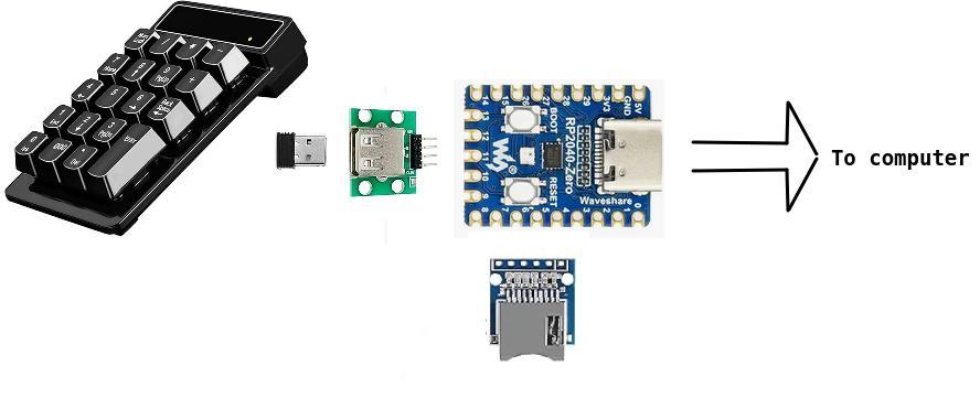

I have been helping a few elderly folks like me play with MMBasic.
My need is to have an RPi2040 take input from a USB keyboard that
is a separate one from main USB keyboard. Do a lookup on and SD card
and send out the text linked to the key hit.
I have been using a BADUSB arduino with 8 keys. To change the text sent
require uploading the code with new text changes.
The keyboard USB id:vendor used for macro's could be passed on and used
as the RPi2040 USB id:vendor to the computer.
I got a few of the wireless USB keypads to try and test.
There is another use for something like this is disabled kids.
I am not sure if it can be done in MMBasic but C would be better.
My neighbor is going to play with Circuitpython.
He tried using a tablet its just not the same as hitting a real key.
Any thoughts

The PicoMite USB firmware does support more than one keyboard but can't currently distinguish between them - i.e. same as windows, key presses on both keyboards are treated the same. If you can get the keypad to send characters that aren't normally used then you could easily use those to trigger text string. The easiest approach would be to define function key strings that the keypad could trigger.

Why not use a USB-PicoMite with a USB keyboard plugged in as the console and then use a USB-TTL uart to a com port and use it as the “macro” input.

It needs to be act as USB keyboard. The RPi2040 takes input an does a lookup
in SD file and then send the text string associated with the key pressed on
keypad as if typed on keyboard.
Hopes this help see better what I am wanting to do.
Quazee137
 It could be treated/thought of as a stream deck but using any
 USB keyboard as the input device.

ok like this I press 0 on the keypad and the RPi2040 looks up 0
 and finds this text "Hello World" then the RPi2040 sends that out
 as if it was typed in.
Example of lookup table
 0,Hello World
 1,This is a test
 2,print "testing"
 3,option list
 4,The quick brown fox jumps over the lazy dog
 5,each lookup slot can have any number of alphanumeric characters
 6,and even things like VT100 codes
the idea is to make any key on keypad or even a keyboard map to
text and control characters going to computer. The computer still
has its main keyboard.
if you plug 2 USB keyboard into computer all keys work as if 1 keyboard.
Here the RPi2040 takes USB key data in and sends what ever is mapped
to that key out as if coming from a keyboard.
using the SD card means you only need to edit the lookup table.
Aw like the Sinclair ZX80 keywords but independent of OS no program needs to do any interpretation.

The RP2040 only has one USB port. The Pico USB system puts it into Host mode so that it can be used with a keyboard or whatever, so it can't be connected to a PC (which is also a Host).
If you then want to connect the same Pico to a terminal it has to be done over a COM port, using a TTL-USB converter for most PCs.
If your wireless keypad is USB then the link to the PC has to be over a COM port and you will have to be running a terminal emulator on the PC.

 What I'm working on is a device that can take any USB keyboard/pad
 and turn it in to a macro keyboard/pad OS independent.
 USB keyboard/pad plugs in and the device will convert the keys to macros
 and send them out as if its a main keyboard/pad. Making any keyboard/pad
 work like the stream decks do. But no buttons on a box.
 Right now looking at 2 waveshare RPi2040 Zero's. One gets the data from
 keyboard/pad looks up the macro assigned to the key hit and maybe using
 spi to 2nd Zero to act as USB keyboard going to computer. Using an SD card
 would make it easy to change the macros. Hold down a button on 2nd Zero
 would make the SD card available as a reader so the table can be modified
 or just plug card in to computer and edit the table. maybe have a display
 to the macro the key is sending. more to think about there.
 I have been looking at some others work using CircuitPython to see how to
 work up the key definitions and how they are represented. Even some mouse
 functions.
 Quazee137
 I know there are macro keyboards but man the cost $$$$

I've had Circuit Python on a RP2040-Zero acting as a simple game controller and simulating key presses to a PC. It works nicely - just like a USB keyboard.
IIRC you can send strings as well as characters.
