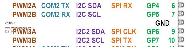

I'm trying to connect a Webmite and a Picomite (both on the same board) with I2c.
I want to read out the 4 CIN pins of the Picomite
the example (picomite 5.08 page 157) works.
But I would like to carry out the transfer without interrupt.
The example below (page 157) doesn't work.
Error: Invalid configuration

All PicoMites (also the webmite) have 2 hardware I2C blocks inside.
These are called I2C and I2C2.
In the pin diagram in the user manual (page 9 for webmite) you can see which hardware block can be assigned the which pins.
But you can write software for 2 independent I2C busses.
Your problem os that GP5 and GP6 belong to different hardware blocks. I suggest you connect the GP5 wire to GP7, change the SETPIN to include GP7 is stead of GP5, then all will be fine.
