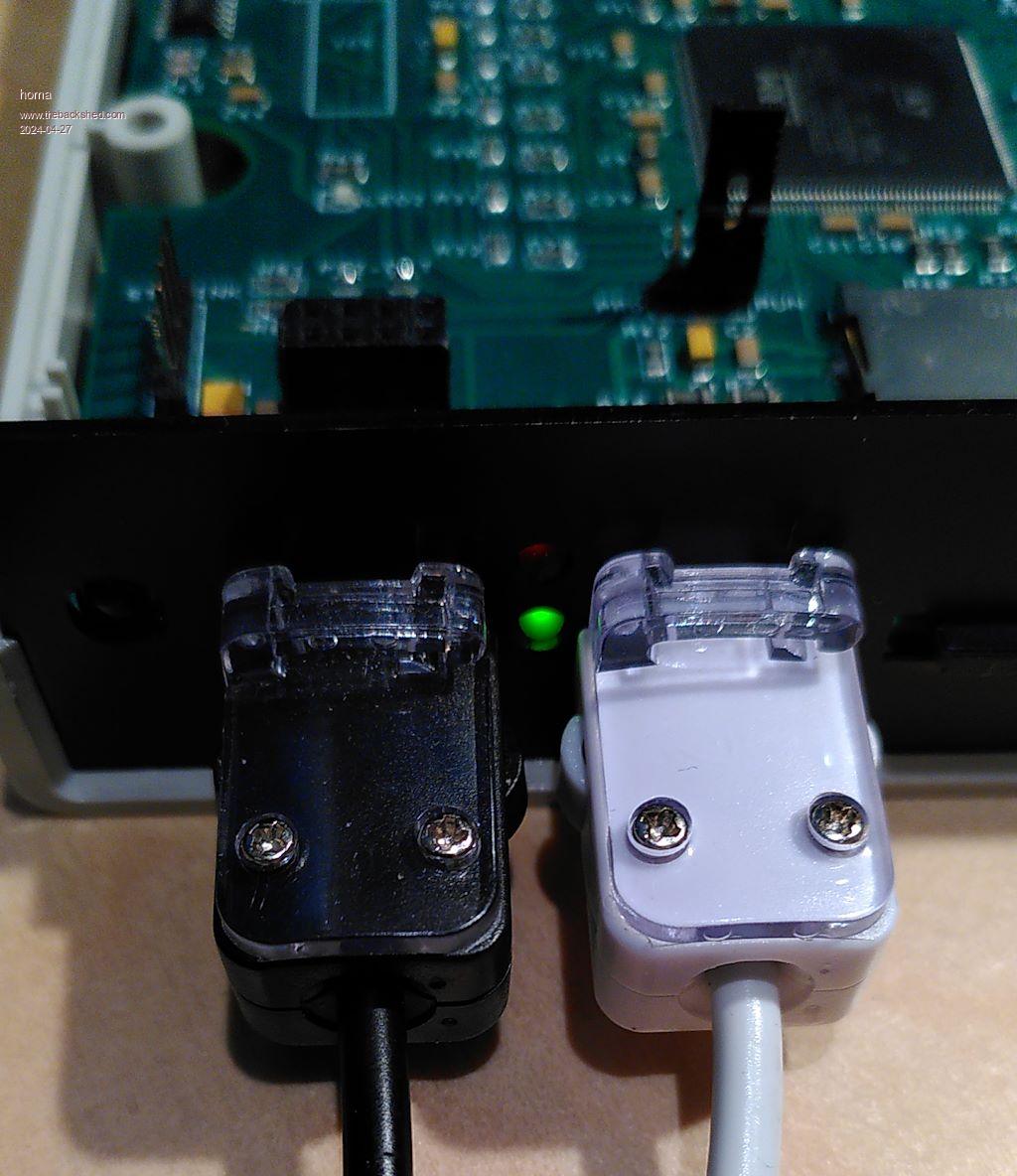

Then I noticed another flaw in the hardware design. You need a tool to get the plugs out of the sockets ;-)
And I can only get the first controller (3) to work.
If I plug in a 2 (controller classic open 2,dada), I get this message:
Error in line 1: Classic not connected
And with a 1 ((controller classic open 1,dada)) I get this error message:
Error in line 5: Not open
Is this because of the Beta FW V5.07.02b11?

  homa said  Now the output of the print command shows an extra 0, which I don't understand! The HEX value also seems to be different from the one given in the manual for this type of controller (A4200101 vs 4200101).
It's a typo in the manual which I've brought up before. The correct code is &hA4200101 (and &hA4200000 for a Nunchuck).
  homa said  And I can only get the first controller (3) to work.
For the two port design the left-hand port is connected to I2C channel 3 and the right-hand one to I2C channel 1. Only the CMM2 Deluxe has a port connected to channel 2.
I believe your mistake is not providing the second parameter in all the calls to the CLASSIC(funct [, channel]) function, if you don't provide a second parameter then it assumes channel 3.
