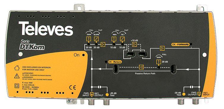

Hi all.
I'm looking for a SMALL UPS.
It must output 230v, but be as small as possible.
The connected load is only 15-20W.
I want to add UPS's to the TV distribution amplifiers at the local village, cos if a house is vacated or is being renovated, the main power is switched off - which kills the distribution amplifier, and dozens of houses loose their TV service.
Ironically, following the 2016 lightning strike that destroyed the old system, the new system uses Televes launch amps out in the field, and they are excellent, with slope adjust and equalizing etc - way better at maintaining a stable TV system then the old amps that got blown to bits, but the old Kingray amps did have the advantage that they used DC power supplies, whereas the Televes ones are mains powered, so I need a mains-power backup solution - but it has to be as small as possible.
Anyone got any ideas or links?
As I say, the load is tiny - 20W or so, so something as small as possible, should be viable, where it would not be if the UPS had to have more grunt.

Posted: 07:13am 30 May 2024
I'm mot sure that these use a SMPS. They specifically specify 110-230V AC, 50-60Hz which makes me think there may be a mains transformer in there, possibly producing more than one voltage. Would the manufacturers clarify this, or even tell you if there's a DC supply option that could be retrofitted?
I'm not sure about the consumption figure. They say 208mA but that's over 20W at 110V, not 15W.
I'd use a 30VA reversed transformer if I was doing an inverter, I think, That's 74 dia x 31mm.
There is a problem in finding a suitable power amp to run from 6V though. The lowest I've found so fat is 8V. That's a 30W bridged output.

Posts: 9960
Posted: 07:58am 30 May 2024
Attached is an image - sorry it is a little fuzzy, I will try to get a good photo tomorrow or something.
"P.max 15W".....
  Quote  makes me think there may be a mains transformer in there, possibly producing more than one voltage. Would the manufacturers clarify this, or even tell you if there's a DC supply option that could be retrofitted?
You could well be right - I don't have one to pull to bits here.
I could order one to pull to bits.  I think I will get management to cover the cost of that.  If we COULD power the thing via batteries or Rob's idea of a LV copper AC to each box that we could then....
Naturally, anything like this kind of mod, would void any warranty....

Posted: 08:19am 30 May 2024
  Mixtel90 said  I'm mot sure that these use a SMPS. They specifically specify 110-230V AC, 50-60Hz which makes me think there may be a mains transformer in there
unlikely that they don't use a SMPS. to achieve operation at both 110v and 230v without any series/parallel switch at the primary requires you to oversize a normal 50/60Hz transformer such that it can:
(a) operate at 230v without overheating,
(b) at 110v still deliver sufficient voltage and current at the secondary.
the end result is a transformer that needs to be several times bigger than would otherwise be needed. if followed by a linear regulator, that also needs to be oversized to handle the increased rectified voltage when there is 230v on the primary.
the only device i've come across with such an arrangement is the Fluke 45 bench meter, that can handle something like 90v to 264v AC. Fluke use a buck converter after the mains transformer to cater to the wide (10-30v DC) rectified voltage range.
for a discussion about replacing the transformer in a Fluke 45 see:
https://www.eevblog.com/forum/repair/fluke-45-transfomer-foobar/msg5314255/#msg5314255
rob   :-)
addendum: from the datasheet and manufacturer's website, "The DTKom Series amplifiers incorporate a built in switched 110-230V AC power supply and are characterized by their exceptionally low power consumption for a long and trouble-free operating life", and, "Includes a high-performance low-power consumption switch-mode power supply".
