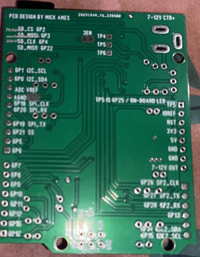

Way back when before I took some time off You had designed some Arduino form factor Picomites.  I built one today, and I can't. find any of the info or notes is can you tell me What the option sdcard string is ? and can you tell me the value of C3 and what it is ? and the rest of the BOM I would like to Build as complete one, and explore the designers full intentions

  Manual said  Where no other devices share the SPI bus the SD Card can be set up with:
OPTION SDCARD CSpin, CLKpin, MOSIpin, MISOpin
So from your top pic:-
OPTION SDCARD gp2, gp4, gp3, gp22
However I wonder if that is a misprint, that sequence is unusual. I would have expected:-  OPTION SDCARD gp22, gp2, gp3, gp4
Edit. Not a misprint. Found the circuit in the Construction pack.zip here

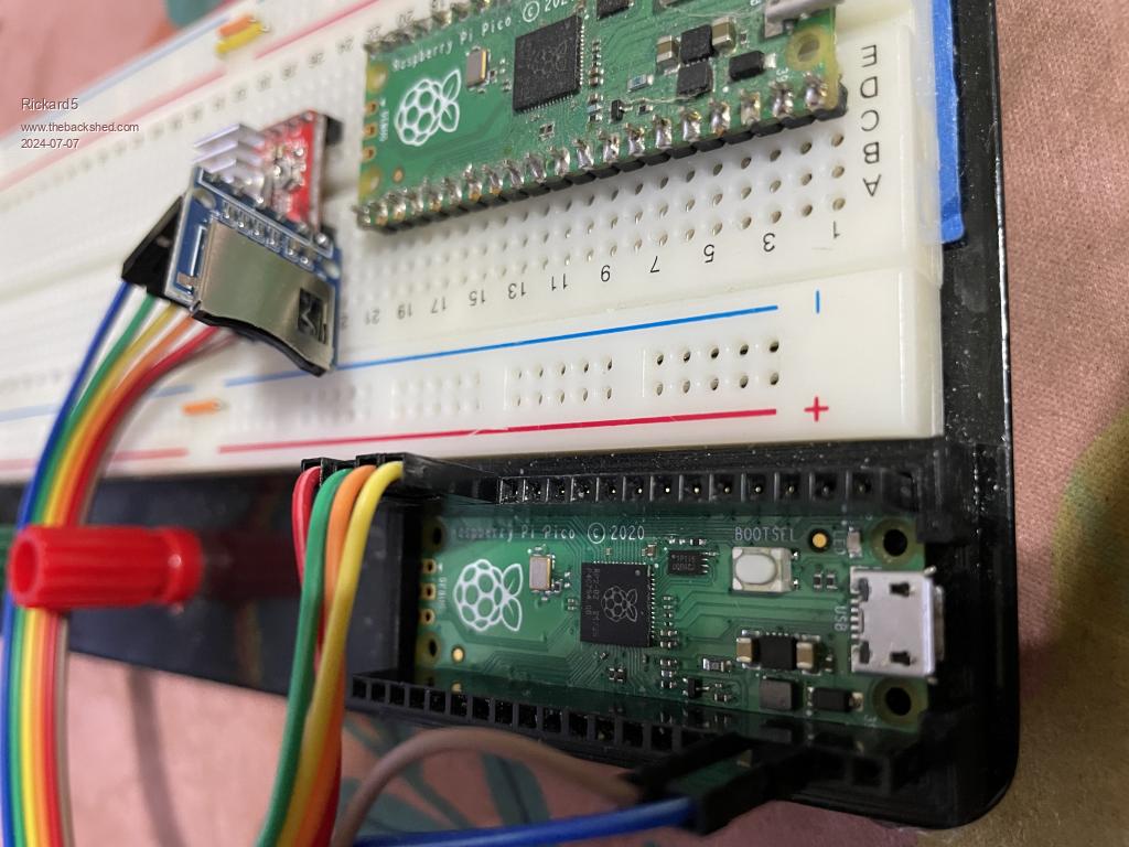

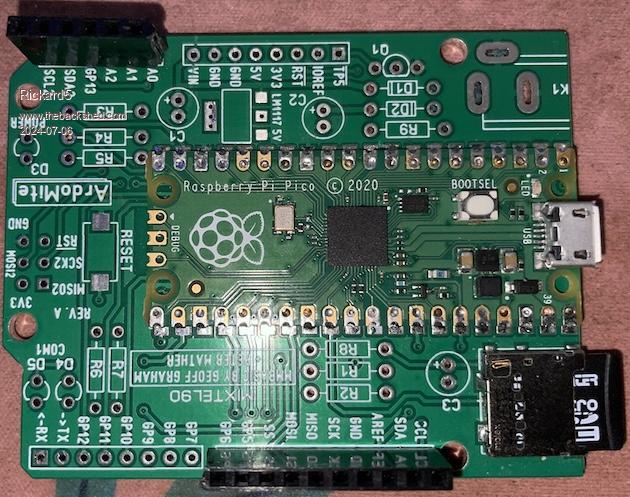

Well I'm doing something Wrong somewhere Every Picomite board I've built I can't get the SD Card to work unless I Hotwire the SD Card socket strait to pins. I have no idea what I'm doing wrong, I've been checking solder joints under microscope and I've even washed boards for 12-14 hopped in ultrasonic to get of flux. I have 4 more of these Arduino boards I'm gonna try. is there any passives I'm missing or do I only need the socket and the Pico?

Arduino's are 5V and SD cards are 3.3V and are destroyed by 5V. So Arduino SD modules usually have a 3.3V regulator and signal level shifters on them.
The Pico is 3.3V so the regulator output may be too low. Measure it, 3V is about the minimum for most cards.
Bypassing the regulator may help but there may still be some signal lost through the level shifters. Some cards can tolerate that but not all.
Direct connection is all that is needed for most cards. Some need extra supply filtering, 10µF or so.
Edit.
If you power the module from 5V the SPI output will also be 5V which the Pico may not like. 1kΩ series resistors in all the signal lines might save the Pico, maybe.

Rick, please list your OPTION list and a list of connections, e.g.
OPTION SDCARD GP1, GP2, GP3, GP4
PICO - SDCARD
GP1 - MISO
GP2 - SCLK
GP3 - MOSI
GP4 - CS
3V3 - VCC
GND - GND
Note, the above won't work, it's merely an example.
The signal pins might be DI and DO rather than MISO and MOSI on the SDcard.
If the SD card works on the breadboard but not on the PCB then you have a PCB track problem. You will have to test every track to the SD card socket with a meter - even a microscope is no use as breaks can be extremely small and the gap filled with solder resist. You will also have to test for short circuits between adjacent pins in that area of the Pico.
If you haven't got a meter (you haven't confirmed or denied that yet) then there is another way. Without setting OPTION SDCARD (and without one plugged in) set all the pins donnected to the SD card to  digital inputs. Then , for each in turn, watch the pin in MMBasic while you connect the SD card end to 3V3 and GND. You should see each one change.
Your original problem was with the Type 1 VGA PCB, wasn't it? Are you now having problems with my Arduino-style design too? Are you sure you are using the correct MMBasic commands to use the SD card in both cases? The ArdoMite pcb looks right, the Type 1 VGA pcb is known to work properly. They use different SD card sockets, so it's not something that's common to those. It's possible, of course, that every SD card that you've tried is faulty, but it's unlikely.

Rick--I've used a module which looks like yours many times. For mine, the pins are 3v3, cs, mosi, clk, miso, 0V. You appear to be using pins 14, 15, 16, 17 (GP10-13). It looks to me like you are using 16 for CS, 14 for MOSI, 15 for CLK, and 17 for MISO.
Based on the standard pinout, I would say that 14 should be CLK, 15 MOSI, 16 MISO, and 17 CS, or OPTION SDCARD 14,16,15,17 (GP10,GP12,GP11,GP13), or OPTION SYSTEM SPI 14,15,16 ((GP10,GP11,GP12) and OPTION SDCARD 17 (GP13).
Untested, and I may have confused myself--but that's what I would try--rewiring and resetting the OPTION(s). (But I have to say, I'm rusty here.)

When I Hotwire the sockets in I'm using,
option SDCARD GP13, GP10, GP11, GP12
PIN
34 3.3V
10. MISO
15  CLK
16  MSOI
17  CS
38 GND
And like I Say it's working Good when I Hotwire them right to the BUS, but the onboard Solder on ones are giving me Fit's. I've ordered new regular and micro sd sockets from amazon, My Goal right now is to build up everything I can with with what I got and start ordering PCBs for what I Missed and get building
Thanks everybody for your help

It would help if you keep to the GP numbers rather than mixing the board pin numbers. ;)
OPTION SDCARD GP13, GP10, GP11, GP12
(CSpin, CLKpin, MOSIpin, MISOpin - as detailed in the manual)
uses
GP13 - 17 - CS
GP10 - 14 - CLK
GP11 - 15 - MOSI
GP12 - 16 - MISO
If you haven't got some fine solder braid and a flux pen I'd recommend that you get them before soldering the SD cards. Use a good dose of flux before soldering and the solder will naturally flow where you want it on the pad. Any excess is easily removed with fine solder braid, which is also great for cleaning up the pads if you have to remove a SMD component.

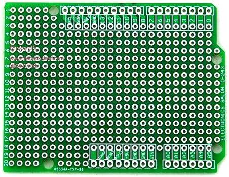

Mick I'm open to most any connector, my Long game Plans is to power them with 18650 Batteries to R/C LiPo Batteries, I'm just more concerned with getting the correct one for the PCB. Also I am a dumb American and worse than That I'm a Dumb Texan, so we NEVER use the Metric system, we work on the Banana Unit of Measurement
  Mixtel90 said   time
There are several things about that board that I don't think I'd do in the same way now. The first is that I'd lose all the mechanical compatibility with the Arduino. It's such a poor mechanical design that it almost makes me want to cry. ......... Of course it's not compatible with Arduino "hats" but as you can't run Arduino code on it anyway that's not really a great loss.
I must Take some or all responsibility I really did and do want a Mechanically compatible because of all the robotic Kits and other Projects that can be 3D Printed and the cool thing is the ready Protoboards availability !

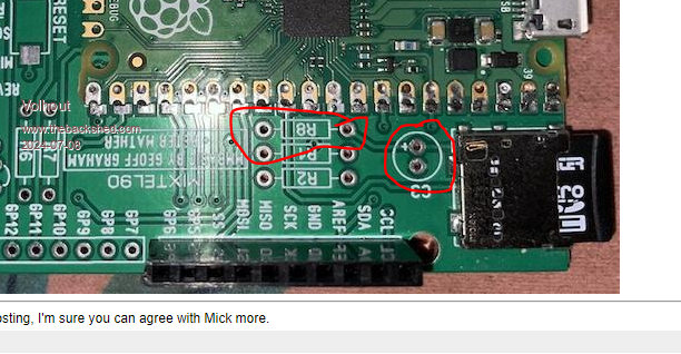

@Rickard,
You need R8 and C3 for the SD card to work.

@ Volholt
Last night I populated this board with what I had including the components you pointed ou snd still NO JOY, when I get back this afternoon I'm going to start all over and try again with a new PCB and Pico :)

Before you put stuff on the new board check for track continuity and shorts on all tracks connected with the uSD card. That way, if you have to check again later, you'll have a better idea on where to look for a fault. The board looks fine to me on SL6, but you can get bad etches now and again.
If you put bits of component lead through the 1mm dia. holes in pads 1 and 21 it will help you line up the Pico properly. Just dab solder them to either the top of the Pico or the bottom of the PCB. You can take them out later when you make the proper joints.
Don't attempt to solder down the holes in the pico if surface mounting it, solder to the inside of the castellations on the outside edge. Some of the joints don'y look too good to me.
