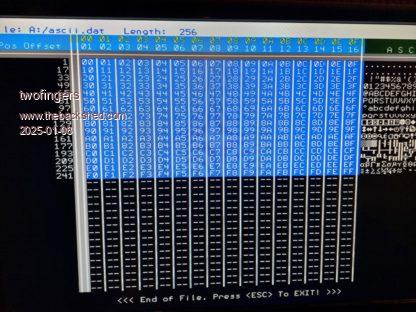

Hi Vadim, all,
I have modified FM 1.14 with some extensions that I think are useful.
These include Harm's FREEPINS,
and my "ListHex" - for displaying binary files. Called with Shift+F3 -, a color table and an ASCII table (F9).
This is a suggestion and if Vadim also finds them useful then I would be happy if they are included in the later versions.
fm115.zip

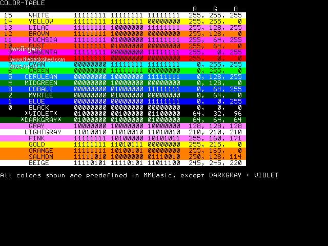

I've worked a bit on the color table:
fm115.3.zip
Note: The colors don't exactly match the screen display of the Pico.

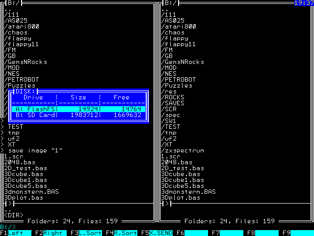

Can you tell me how I can switch to drive B: in the left-hand window? I have not been able to do this yet...
Frank
Posts: 6029
Posted: 09:04am 16 Jan 2025
Hi Frank,
Press ALT F1, and select B
Frank N. Furter
Joined: 28/05/2012
Posts: 1147
Posted: 10:09am 16 Jan 2025
@Volhout:
THANKS!!!
...have I overlooked that somewhere???
Frank
UPDATE:
ALT+F1  does not work for me. It makes no difference to me whether I hold down the ALT key while pressing the function keys or not. (I have tried two keyboards...)
