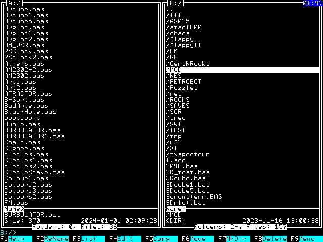

javavi
Joined: 01/10/2023
Location: Ukraine
Posts: 544
Posted: 11:22pm 27 Jan 2025
Updated FM a little to version 1.21
+ Alt works from USB keyboard
+ Stop playing track with SPACE
+ Working on F9 Menu
FM121.zip

javavi
Joined: 01/10/2023
Location: Ukraine
Posts: 544
Posted: 12:07am 02 Feb 2025
Updated FM to version 1.23
FM123.zip
+ works from USB keyboard
+ Sort Order - [BackSpace] switch key (???)
+ and other code optimizations
Perhaps someone can suggest a more convenient button for switching the sorting order?
Thanks to @twofingers for the method of sorting files, I honestly spied on you
Although this sorting noticeably slowed down the update of the disk panel with a large number of files.
Other tips for improving the program interface are also accepted.
disco4now
Joined: 18/12/2014
Posts: 1109
Posted: 01:48am 02 Feb 2025
  javavi said  Perhaps someone can suggest a more convenient button for switching the sorting order?
Have you considered using CTRL+[A-Z]. I think these plus a few other combinations produce the lower ascii codes 0-31. Just don't use CTRL+C. Maybe CTRL+S(ort). Should also work from VT100 terminal.
