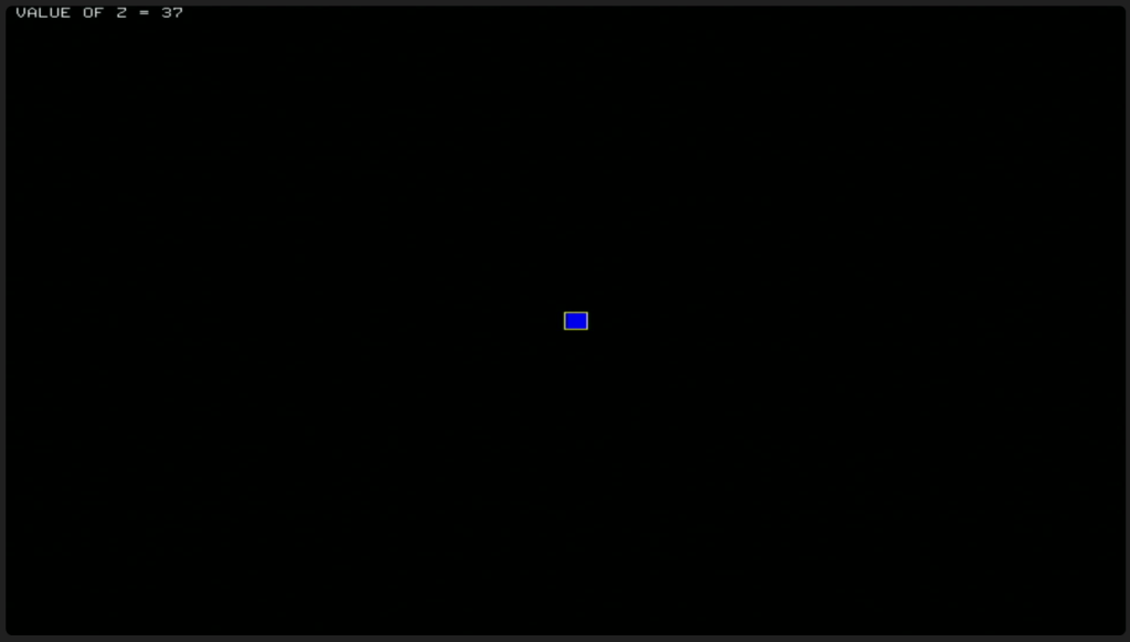

I've been playing with the awesome 3D commands on the CMM2, but I'm having a bit of trouble understanding what's going on here.
I have a cube that starts in front of the camera and moves towards the camera (down the Z axis). After it passes through the camera, it reappears as if moving away from the camera.
Now, it's not a problem in real life, because realistically I would cull everything behind the camera before drawing, but I'm just wondering if I'm completely failing to understand the 3D camera.
Here's the code:
OPTION EXPLICIT
Create3DCubeSubroutine() ' Creates a cube as object #1
DIM FLOAT z=500          ' Cube starts off 230 points away on the Z axis
PAGE WRITE 1
DRAW3D CAMERA 1,300,0,0
DO
 z=z-2                  ' Decrease Z so that cube comes towards camera
 CLS RGB(BLACK)
 PRINT "VALUE OF Z = " + STR$(Z)
 DRAW3D WRITE 1,0,0,z
 PAGE COPY 1,0
 PAUSE 20
LOOP
SUB Create3DCubeSubroutine
 DIM FLOAT vertices(2,7)=(-1,1,-1,1,1,-1,1,-1,-1,-1,-1,-1,-1,1,1,1,1,1,1,-1,1,-1,-1,1)
 DIM INTEGER facecount(5)=(4,4,4,4,4,4)
 DIM INTEGER faces(23)=(0,1,2,3,1,5,6,2,0,4,5,1,5,4,7,6,2,6,7,3,0,3,7,4)
 DIM INTEGER colours(6)=(RGB(BLUE),RGB(GREEN),RGB(RED),RGB(CYAN),RGB(RED),RGB(BLUE),RGB(YELLOW))
 DIM INTEGER edge(5)=(6,6,6,6,6,6)
 DIM INTEGER fill(5)=(0,1,2,3,4,5)
 DRAW3D CREATE 1,8,6,1,vertices(),facecount(),faces(),colours(),edge(),fill()
END SUB
And this is shot by shot display of what happens
It starts off fine with cube moving towards the camera (note the Blue face is facing the camera).
Getting closer still, this is working as expected - note the Z value at the top of the screen.

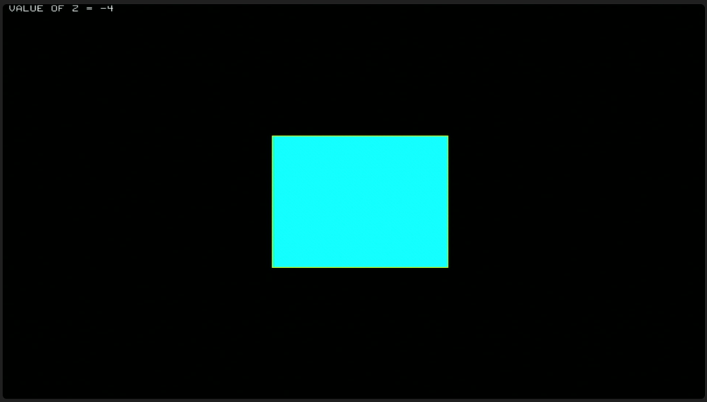

There is a brief moment when the camera is inside the cube at Z=0, where everything goes wonky - this is to be expected.
But then as the cube moves behind the camera, it reappears (note the Cyan side which is the rear of the cube).
And continues to vanish off into the distance
Am I doing something incorrectly? I've read and re-read the 3D manual/notes repeatedly but can't see what I'm doing wrong.
Thanks in advance,
Pete

Posted: 04:50pm 07 Oct 2024
For my Stellar Battle in the Seven Green Hills Zone with the 3D engine, I had to make a point of not drawing anything with a Z less than some (positive) cut off value, determined experimentally. So yes, I found some issues when objects were right up close and friendly.
To speed drawing, I also don't draw anything with ABS(X) < Z. (Y was fixed at 0.) This worked for my chosen zoom factor which gave a roughly 90 degree field of view.

Posted: 08:36pm 07 Oct 2024
Thanks Pete. You've confirmed that I'm not missing something fundamental. I did have logic to not draw anything out with of the field of view - but I turned it off at one point and got all sorts of weird things happening that I couldn't explain. Then I refined it down to the simple demo code that I posted above, and was worried that I had completely misunderstood the way the camera worked. It wouldn't be the first time one of my programs worked correctly and I had no idea why
I had forgotten about your Stellar Battle in the Seven Green Hills Zone, I'll have to look at your source and see what else I can learn. Thank you again!

Posted: 08:05pm 09 Oct 2024
  LeoNicolas said  Hey Pete
Can you post your fixed code? Maybe it can be used as base for other 3d games
The code above was just generated from a distilling down of my current game project. A simple way to cull on that would be to just only do the DRAW3D WRITE command if Z>5. But my full code is too messy for me to publish just yet. If I ever get it finished, it will of course be published with fully commented code.
Maybe as an interim I will extract out the 3D code and publish it earlier, so others can use it. But it's not quite there yet.
