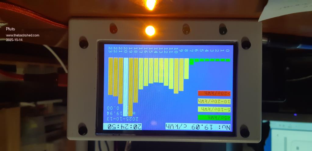

I have to renew my energy supply contract soon. The new contract will be SPOT based and suddenly it becomes interesting to follow the electricity price hour by hour and also to check prices for the next day. This could in the simplest way be done on the PC or with phone apps, but much more interesting to make use of one the WebMites laying around my desc. I have found some (hopefully) useful sites with price info for the Finnish electricity market. One of them is called "sahkohinta-api.fi". Unfortunately only in finnish. On Google Chrome you just have to enter: https://www.sahkohinta-api.fi/api/v1/halpa?tunnit=1&tulos=haja&aikaraja=2024-11-15 to find the cheapest hour in the day. The reply looks like this [{"aikaleima_suomi":"2024-11-15T23:00","aikaleima_utc":"2024-11-15T21:00","hinta":"-0.08700"}] (yes; negative price tonight between 23:00-23:59). Timestamp FI, Timestamp UTC, hinta=price (eurocents/kWh)."sahkohinta-api.fi" is a free service. No need to register and you can use it 60 times per hour max. There are a few different "api-requests": a. Search for the cheapest hour b. Search for the most expensive hour c. Search for the cheapest hours (you define how many to list) d. Search for the most expensive hour (you define how many to list) I have tried to do this on a WebMite by using WEB TCP CLIENT without success. Without sufficient knowledge I have tried several times by trial and error (and only error) like this OPTION EXPLICIT OPTION DEFAULT NONE Dim buff%(4096/8) DIM A% = 1000 'Dim b$= "GET /api/v1/halpa?tunnit=[2]&tulos=haja&aikaraja=[2024-11-15] HTTP/1.1\r\nhost:sahkohinta-api.fi\r\n\r\n" 'Dim b$= "GET /api/v1/halpa?tunnit=[2]&tulos=haja&aikaraja=[2024-11-15] HTTP/1.1\r\nhost:sahkohinta-api.fi" 'dim b$="GET / HTTP ap1/v1/halpa?tunnit=1&tulos=haja&aikaraja=2024-11-15"+Chr$(13)+Chr$(10) dim b$="GET ap1/v1/halpa?tunnit=1&tulos=haja&aikaraja=2024-11-15" WEB open TCP CLIENT "SAHKOHINTA-API.FI",80 WEB TCP CLIENT REQUEST b$,buff%(),10000 'web TCP SEND 1,b$ 'web tcp read 1,buff%() 'web tcp read 1,buff%() WEB close TCP CLIENT 'a%=LinStr(buff%(),"{")-1 'If a% <> -1 Then 'LongString trim buff%(),a% LongString print buff%() Print Json$(buff%(),"hinta") Connected [10] WEB TCP CLIENT REQUEST b$,buff%(),10000 Error : No response from server > option list WebMite MMBasic Version 6.00.00RC15 OPTION SYSTEM SPI GP18,GP19,GP16 OPTION LCDPANEL ILI9341, LANDSCAPE,GP15,GP14,GP13 OPTION WIFI HuaHuaNisse, ***********, PICOE6616408432 OPTION TCP SERVER PORT 80 OPTION TOUCH GP12,GP11 GUI CALIBRATE 0, 190, 227, 909, 668 I am not sure if the TCP is the correct route. What else could be tried? Is there any way to see what Chrome is actually sending when you issue the command in the browser? I briefly read the lectures by Luc again, but for this case I did not find any hints. Should maybe read more carefully. Any help and ideas are appreciated. Thanks, Pluto |

It seems that all potentially useful datasuppliers I have found use HTTPS. Its a pity that WebMite can't work with HTTPS. I suppose there is not any work-around to get WebMite to work with HTTPS. Should it be better to try with ESP8266 or ESP32 and Annex? Do they manage with HTTPS? (My previous experience with ESP8266 is not very positive...) Maybe I have to skip the whole idea about an on-line PicoMite price-indicator. Had also planned to have a price based controller for the water boiler. I think that the idea has to rest until WebMite is HTTPS-compatible. Thanks for help and comments! Fred |
