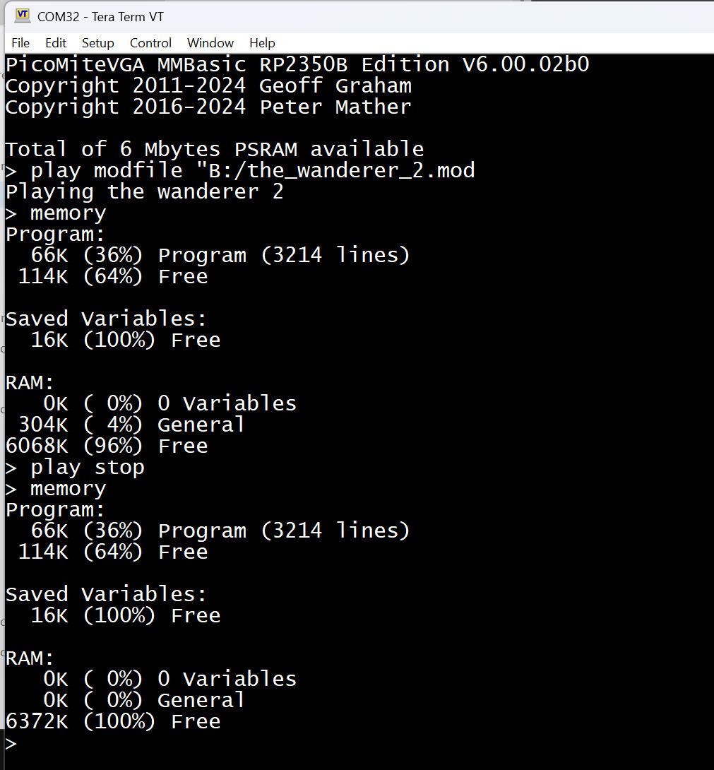

To play music in MOD format, a MODBUFFER is used, which is located in the Pico flash, and each time a composition is loaded, this area of ​​​​flash memory is reflashed, which is not good for intensive listening to many compositions.
Is it possible to make it so that if there is a PSRAM, this MODBUFFER is located in it?

Posts: 12252
Posted: 05:25pm 15 Jan 2025
  Quote  To play music in MOD format, a MODBUFFER is used, which is located in the Pico flash, and each time a composition is loaded, this area of ​​​​flash memory is reflashed, which is not good for intensive listening to many compositions.
Wrong thread - but good idea
