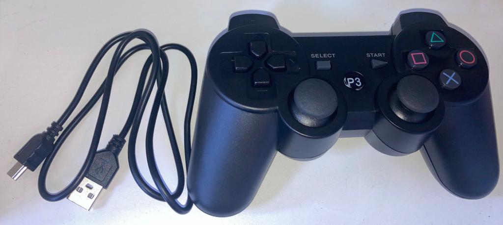

Posts: 12252
Posted: 05:36pm 02 Feb 2025
I've no idea how you parse that. The only thing I can get from a controller is its report description. For my gamepad it is as follows - nothing useful on button allocations

// vid ==  0x054c && pid == 0x0268
030000004c0500006802000000000000,
PS3 Controller,
a:b2,
b:b1,
back:b9,
dpdown:h0.4,
dpleft:h0.8,
dpright:h0.2,
dpup:h0.1,
guide:b12,
leftshoulder:b6,
leftstick:b10,
lefttrigger:a3~,
leftx:a0,
lefty:a1,
rightshoulder:b7,
rightstick:b11,
righttrigger:a4~,
rightx:a2,
righty:a5,
start:b8,
x:b3,
y:b0,
platform:Windows,
void process_sony_ds3(uint8_t const* report, uint16_t len, uint8_t n)
   nunstruct[n].type=PS3;
   uint16_t b=0;
   if(report[3]&0x80)b|=1<<12; // byte 4, bit 7 - Button Y - b0
   if(report[3]&0x40)b|=1<<13; // byte 4, bit 6 - Button B - b1
   if(report[3]&0x20)b|=1<<11; // byte 4, bit 5 - Button A - b2
   if(report[3]&0x10)b|=1<<10; // byte 4, bit 4 - Button X - b3
   if(report[3]&0x8)b|=1;      // byte 4, bit 3 - Button R - b7
   if(report[3]&0x4)b|=1<<4;   // byte 4, bit 2 - Button L - b6
   if(report[3]&0x2)b|=1<<9;   // byte 4, bit 1 - Button R2 - are these the analog triggers (a4~) or the stick buttons (b10) ?
   if(report[3]&0x1)b|=1<<14;  // byte 4, bit 0 - Button L2 - are these the analog triggers (a3~) or the stick buttons (b11) ?
   if(report[2]&0x80)b|=1<<8;  // byte 3, bit 7 - Button Left - h0.8
   if(report[2]&0x40)b|=1<<5;  // byte 3, bit 6 - Button Down - h0.4
   if(report[2]&0x20)b|=1<<6;  // byte 3, bit 5 - Button Right - h0.2
   if(report[2]&0x10)b|=1<<7;  // byte 3, bit 4 - Button Up - h0.1
   if(report[2]&0x8)b|=1<<1;   // byte 3, bit 3 - Start - b8
   if(report[2]&0x1)b|=1<<3;   // byte 3, bit 0 - Select (Back) - b9
   if(report[4]&0x1)b|=1<<2;   // byte 5, bit 0 - Home (Guide) - b12
   nunstruct[n].ax=report[6];
   nunstruct[n].ay=report[7];
   nunstruct[n].Z=report[8];
   nunstruct[n].C=report[9];
   nunstruct[n].L=report[18];
   nunstruct[n].R=report[19];
