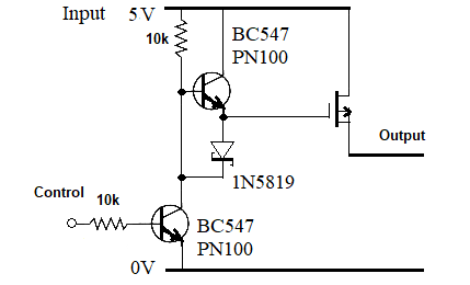

For faster switching use an active pullup to switch the P-channel MOSFET off.
Edit. I messed up the MOSFET symbol but you get the idea.
Edited 2025-08-07 22:49 by phil99
