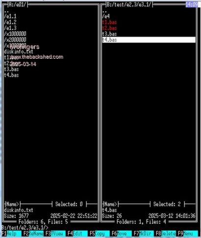

This is the next improved version of FM V0.2023.
In addition to fixing a few minor bugs, there's a new feature: displaying the total file sizes of the selected files.
fm-vt100-02025.zip

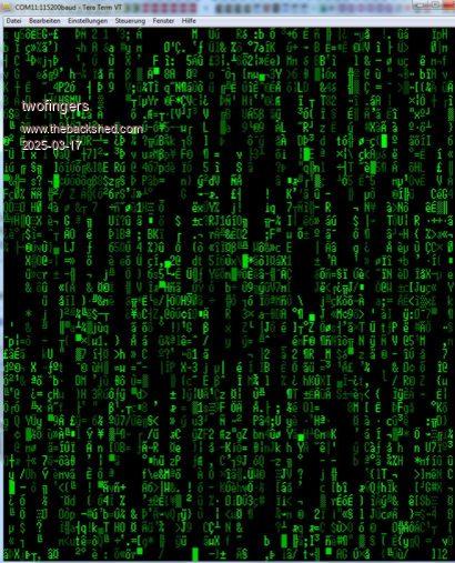

Here is a new screensaver. It is based on 256 color implementation in the terminal program. Looks a lot closer to the original...
It is tested on Putty.
I will see if TeraTerm works on monday.

Posted: 03:33pm 16 Mar 2025
Hi Harm,
why wait until Monday? I think it looks good! (But the screensaver isn't that important to ME.) It's a good exercise!
I was  wondering about whether certain patterns could shine (as black) through. Something like a skull or something similar.
Have you formed an opinion on displaying the file sizes of sorted files? Does it make sense? Is the display optimal?
Michael

2026: Selecting multiple files works nice. Also the display of files and file size is fine. I have not tried yet with very large files, to see if size digits are cut off(*). But showing size is handy, then you know it actually fits (i.e. on the A:/ drive).
The only thing I found remarkable is the color of the popups. "Are you sure" in violent yellow. Can't be missed....
(*) up to 9.999 megabyte (7 digits) should be fine.

  Quote   the color of the popups.
This is intentional, because I think a clear warning is needed when many selected files are about to be copied or deleted. However, I'm not entirely satisfied with the VT colors; they could be a bit more subtle. Any suggestions?
