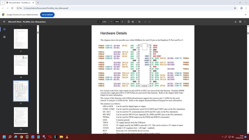

looking  in the manual is this correct please?
card pins
gnd
miso-----GP4
clk------GP6
mosi-----GP7
cs-------GP22
3v3--- from pico or usb to ttl
then use OPTION SDCARD GP22,GP6,GP7,GP4
haven't tried cos only 6 wires I could mess up.
Posts: 8904
Posted: 06:51pm 13 Jun 2025
The top module will work. The bottom one might work, might not or might be touch and go, depending. :)  It's intended for a 5V supply. The voltage regulator won't regulate if you power it at 3V3 (not enough voltage across it) and the level shifter might be marginal because of that.
All SD cards are 3V3. They work fine when fed from the Pico. You can probably use the socket in the bottom picture by powering it from 5V rather than 3V3. Take the supply from VSYS.
For testing purposes you can use any GPIO pins for a SD card providing you specify them all in OPTION SDCARD.
Edited 2025-06-14 04:54 by Mixtel90
