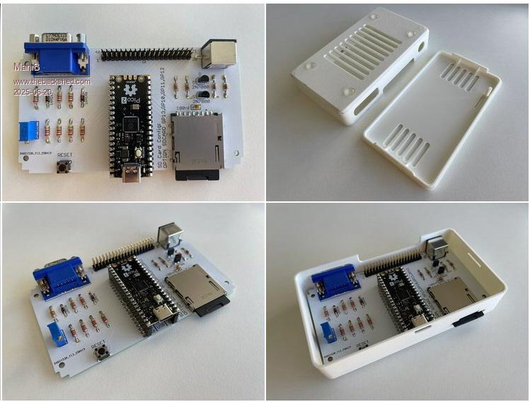

ManiB
Joined: 12/10/2019
Posts: 159
Posted: 06:38pm 19 Jun 2025

ManiB
Joined: 12/10/2019
Posts: 159
Posted: 07:53pm 19 Jun 2025
  mathom said  Got it! Thank you!
if you want something more solid than your breadboard solution, I recommend the PicoMiteVGA Construction Pack:
https://geoffg.net/Downloads/picomite/PicoMiteVGA_Construction_Pack.zip

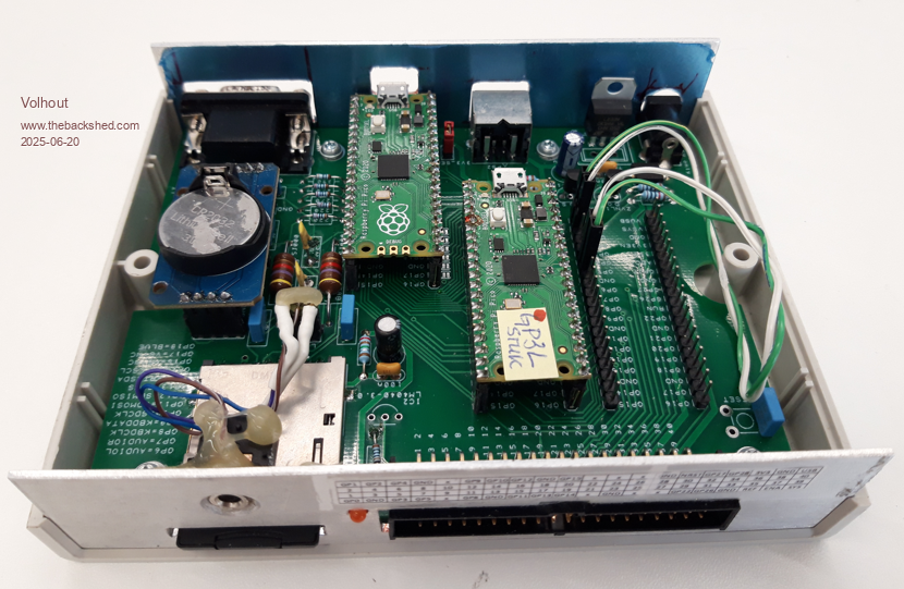

Posts: 6022
Posted: 06:23am 20 Jun 2025
Hi ManiB,
Yes, that is the grand-dad of all the stand alone pico basic computers.
There is also a VGA design 2, where audio is added, and the optional RTC (and breadboarding footprints). I started, and still love, VGA design 2.
In this photo a breadboard footprint is used for a second pico, that runs a chess program. The main pico is for display of the chess board, and keyboard interface.
The "breadboard sockets" are very nice for playing with interfaces (like the SSTV interface, the MORSE interface, etc...).
Note that VGA design 2 is just an extended VGA design 1. Just RTC and Audio added (and the breadboard footprints).
If you desire to retro-fit audio and RTC in VGA design 1 added later on, Peter made a piggy-back board for that, I think the design files are on this forum.

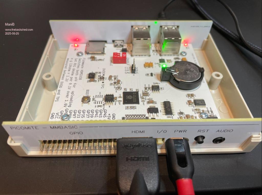

ManiB
Joined: 12/10/2019
Posts: 159
Posted: 11:04am 20 Jun 2025
Yes Volhout, i know ;)
and this is the latest refernce board from Peter:

DigitalDreams
Joined: 03/05/2025
Posts: 65
Posted: 07:29pm 20 Jun 2025
  ManiB said  Yes Volhout, i know ;)
Where are the details for this ?. I'd love something full featured that can fit in a small case with keyboard and touch screen plus lots of free i/o, space for several additional modules, holes for mounting a heatsink on the processor and dual 18650 batteries !
ManiB
