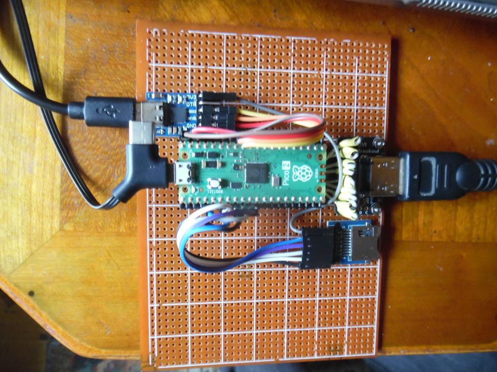

Posts: 2807
Posted: 02:42pm 24 Jul 2025
usb to ttl converter and don't know if using gp20,21 for it causes problems. works .
Posts: 8904
Posted: 03:22pm 24 Jul 2025
Don't over-complicate it, Stan. :)
A USB setup wants the console serial port on GP8 and GP9 *by default*, although you can change it. Keep things as simple as possible when fault-finding, with everything as defaults where possible. GP20 and GP21 will *not* work for a console unless you set them up as an OPTION. By default they are just ordinary GPIO pins.
Posts: 2807
Posted: 04:39pm 24 Jul 2025
sorry Mick, just showing usb to ttl one side of pico and sd card other. sd card needs 3.3V supply I wired from usb to ttl.
I reset the com pins and sd card pins from manual.
Roy should use non usb first try maybe and mmedit and mmcc via win pc
and default pins in the manual

Posts: 8904
Posted: 02:46pm 26 Jul 2025
It's highly unlikely that Windows will issue COM 1 to a virtual serial device. It's far more likely to be at least COM 6. Com 1 will be an internal USB hub for the PC sockets. Check Device Manager when you plug the Pico in to see what COM port appears. If you click the drop down box in Tera Term it'll usually be the bottom of the list.
The USB version of the firmware does NOT have any console access via USB from the moment that it starts running, you MUST use a USB-TTL converter attached to a COM port on the Pico. The default port is on GP8 and GP9 and the baud rate is 115200 Bd. Once the firmware is running there is no other way to talk to the Pico unless you unplug the PC and plug a USB hub or keyboard into the Pico's USB as it is now running in USB Host mode.
If you are using the HDMI USB version of the firmware then the display will become operative as soon as the Pico firmware is running.

Posts: 5927
Posted: 03:20pm 26 Jul 2025
When you can upload mmbasic, the cable and connection are okay. The slow fflashing led shows mmbasic is running.
The only reason it might not work is when you programmed a mmbasic version that is not designed to have console communication on usb.
Please make sure the firmware you program is correct.
Picomite...USB....uf2 is designed to connect a keyboard to the pico usb port.
Picomite..........uf2 is designed to connect a console/terminal/mmcc to the usb port.
So.. to use the usb port with mmcc, program a uf2 file that does NOT contain the characters USB in its name.
