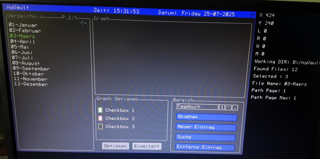

Hello all, I'm spending the whole day wrapping my head around this problem.
I am using the latest PicoMiteVGA Firmware.
the Files command allows to list the files sorted by name, for example. But this command isn't available in the program itself. BUT there is the DIR$ command.
It does just what I want, but with a big problem, it ALWAYS sort the DIRs by the date or time of creation. I've tested this many times with folders. To make things clear, I've freshly created folders one after one with this scheme:
first I created folder named "1"
then ... "7"
..10
..22
..5
  Quote  there is no way to sort the printing like:
1
5
7
10
22
Background:
I trying to save a listing in an array like this:
Dim String directory(200), fileName
Dim Integer foundFiles
f$=Dir$("*",Dir)
Do While f$ <> ""
   Inc foundFiles
   fileName= f$
   directory(foundFiles)=fileName
   f$=Dir$()
'print the array
For n=1 To 30
 Print directory(n)
Next n

Amnesie
Joined: 30/06/2020
Posts: 763
Posted: 12:36pm 25 Jul 2025
Hey, I can't thank you enough for pointing me in this direction!
I've tried to isolate the code snipped and it works perfectly! Now there is only one task left: to UNDERSTAND it  , but with the help of the manual and the SORT command, I think this is doable.
For everyone who may need this code snippet:
Dim string  TMP$
Const RMAX=199  'Max number of Records in File List (255 max)
Dim string  FList$(RMAX)  LENGTH 63
Dim integer RQt,DQt,FQt,S,i
TMP$=Dir$("*",DIR)
Do While TMP$<>""
 If RQt=(RMax-1) Then Exit Do
 Inc RQt: Inc DQt
 FList$(RQt)="/"+TMP$
 TMP$=Dir$()
Sort FList$(),,2,1,RQt
For n=1 To 30  'change here for max listing...
 Print FList$(n)
Next n
Thank you again for this fast response! This helped me a lot!

Amnesie
Joined: 30/06/2020
Posts: 763
Posted: 01:04pm 25 Jul 2025
  twofingers said
Really? That shouldn't work! Something's missing! I think—at a quick glance—you're only reading directories and not sorting yet.
But I don't want to complain if that's enough for you.
Michael
Hint:
To sort the file properties, you need a numeric index(rMax) array.
Uhmm... I don't know but it works. I tried it with different folders.
I thought:
does the sorting... And the printing of the array does give back a sorted array of strings...
Print FList$(n)
Next n
This gives me a perfectly sorted list... What I am missing? May I have found a bug (to my favour?)
Greetings
Daniel
Edited 2025-07-25 23:08 by Amnesie

Amnesie
Joined: 30/06/2020
Posts: 763
Posted: 01:22pm 25 Jul 2025
Ah, maybe here comes the missunderstanding!
I am not interested in sorting file properties at all. I am only interested in the name of the folder (or file).
I just wanted a sorted list of strings, If you will. But thanks for this explanation!
I am working on a "journal / diary" application with graph stats and so on... this is why I was in need of sorting it and don't care about file properties:
Greetings
Daniel
Edited 2025-07-25 23:35 by Amnesie

Amnesie
Joined: 30/06/2020
Posts: 763
Posted: 03:01pm 25 Jul 2025
Ah! Now I completly understand what you mean!
TMP$=Dir$("*",DIR)
should only read folders.
Yes, yes it does! It only reads folders.
What I initially wanted to say is the following:
Thanks to your hint with Vadims FM, I sucessfully cut out the code snippet and it works AS is in this example (only for DIR, of course). But I implemented it already in my program, the crucial hint from you, was the SORT command I wasn't aware of. I already adapted it in my program, since it was only one line to add!
I am completely aware of the fact, that there are three parameters: DIR, FILE, ALL
Typischer Fall von einander vorbeigeredet würde ich sagen   Ich danke dir vielmals - absolut entscheidender Hinweis von dir!
Greetings
Daniel
