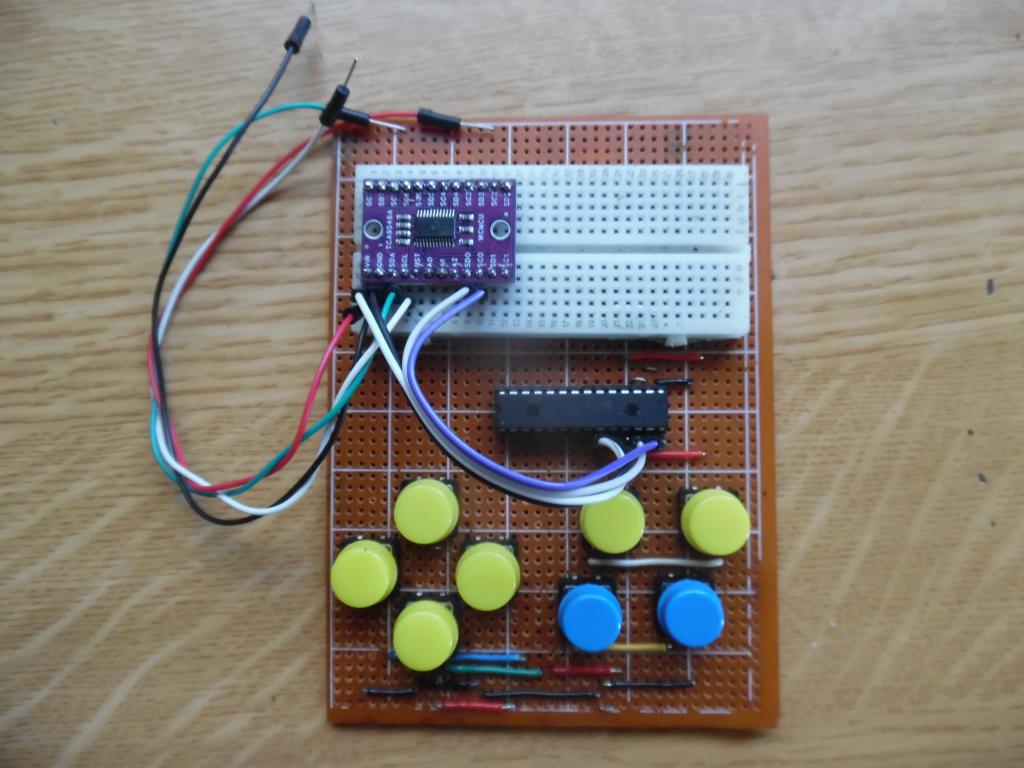

I ordered a TCA9548A. I will probably ask for help cos don't use i2c much.  V53L0X, MCP23017, ssd1306

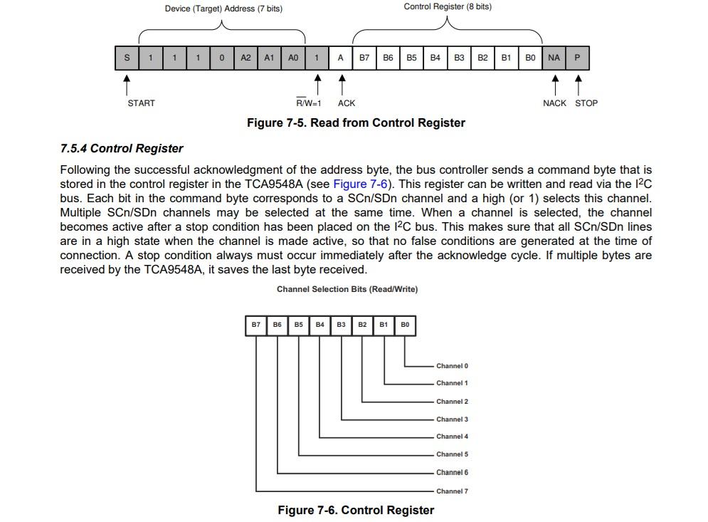

The info for using I2C is in the manual, Appendix B, and it's pretty good! It's not much more difficult than using a COM port. The main thing is that it's up to you to create the protocol that you want for a particular job.

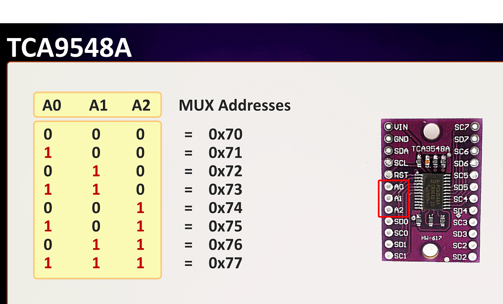

The module is easy to work with. If the address pins are all grounded it's address is &h70 The individual channels are then &h0 to &h7 so you send &H70 for the first, &h71 for the second, &h72 for the third etc. There are no other registers in it. Once you have selected the channel like that you just use the I2C as normal to talk to the device that you want.

Posted: 03:31pm 29 Jul 2025
dunno if a0 to a2 are hardwired or go to gp pins.
Posts: 5930
Posted: 03:35pm 29 Jul 2025
Easy, connect the module to your desired I2C bus, and run an I2C scan. From the address found you know the wiring.
Posts: 2807
Posted: 07:39pm 29 Jul 2025
this is just the devices i2c addresses itself which can be 0x70 to 0x77. mines in the post. solder it up and post

I don't get this. the tca has address so writing 2 bytes to it to set up a device and the register so what channel conected to for each device
Posts: 8904
Posted: 09:21pm 31 Jul 2025
It's easy enough.
You are sending one byte (B7-B0) to the address of the TCA.
The TCA address is [0]1110[A2][A1][A0] - that's 70 to 77 depending on the address pins.
The next bit is 0 to read from it or 1 to write to it. You are selecting a device, so this will be a 1 so that you can write to the device select strobe.
The next 8 bits after the ACK (which is automatic) are the device strobes, one per I2C port. So a 1 on B0 will select port 0, a 1 on B1 will select port 1 etc. All non-used ports have their strobes set to 0.
It's possible to select two I2C ports at the same time (not sensible for many devices) by setting both their strobe bits high.

Posts: 2807
Posted: 06:56pm 02 Aug 2025
I not knocking the device but admit I don't use i2c. all were experimental and the 16 channel gpio was great but who else got one and the laser rangefinder was brill connected to i2c oled. no mux needed. got so far and lost interest with device
Posts: 2807
Posted: 09:30pm 02 Aug 2025
this has 16 io and you could have 8 devices and you can have 8 tca so (16*8)*8=1024 io for whatever
