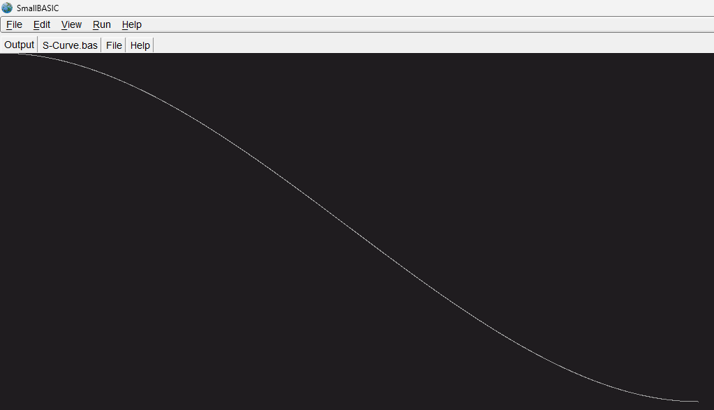

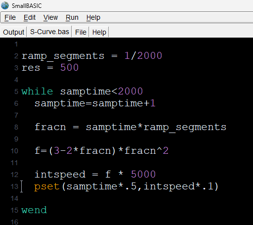

For someone elsewhere, I just had to prove that my S-Curve acceleration routine did in fact work, by generating a plot.
Look at any other solution out there because I haven't found one that isn't horrendously complicated
I know how to do this on the PC using SmallBASIC and so that's what I used.
Basic just totally rocks, I don't care about this "non standard" talk because modifications are usually trivial.

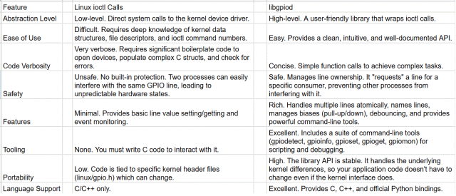

  matherp said  PIGPIO hasn't been updated in 4 years. This doesn't use PIGPIO but Linux IOCTL calls.
I asked Google Gemini to "Compare Linux IOCTL calls and libgpiod".
This gets to the core of modern GPIO interaction in Linux. Comparing raw ioctl calls and libgpiod is like comparing assembling a car from individual parts versus driving a fully manufactured car. Both achieve the goal of "transportation," but the experience, safety, and features are vastly different.
In short, libgpiod is the modern, recommended, and vastly superior way for user-space applications to interact with GPIOs. The raw ioctl interface is the low-level kernel mechanism that libgpiod uses under the hood.
Here is a detailed comparison:
Why would anyone use IOCTL now?

  robert.rozee said  each additional layer of abstraction (1) adds overall complexity, (2) consumes additional computing power, and (3) increases memory requirements
In my experience as a programmer (since 1970), (1) is usually not true--abstraction behind the scenes (by others) simplifies the programs that I write, and Moore's law has made (2) and (3) fundamentally irrelevant in the vast majority of cases.
In the particular case of Linux running on current devices (even tiny ones), it's not likely often to be the case that computing power or memory requirements constrain one to use IOCTL rather than libgpiod (when available).
Concerning availability, the most up-to-date libgpiod is not available for installation on Raspberry pi using apt, but you can easily download and compile it. The next release of Raspbian (perhaps later this year) is expected to have the latest (later?) version of libgpiod, which is included in Debian 13 (officially released August 9).
