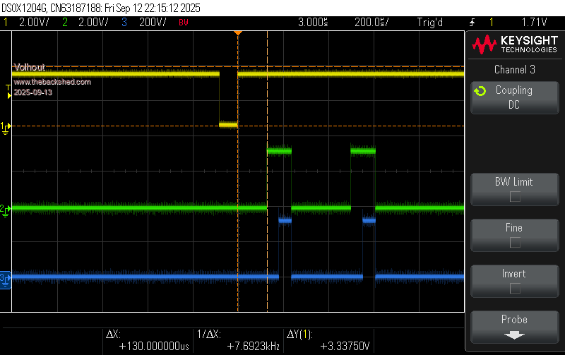

Posts: 5930
Posted: 02:26pm 12 Sep 2025
Hi Vincent,
For you to try out, a possible PIO example of the marker generator.
Yellow trace = GP0 = input signal
Green trace = GP1 = T1 output signal (here the PIO pulls it low at falling edge input) T1=128uS T2=500us
Blue trace  = GP2 = the T3 signals T3=50uS
This is for T1 and T2. The P4 and P5 signals are not implemented yet.
You can define both state machines drive the same GPIO's if you like. Both state machines run the same program, but can use different FIFO's and IO's.
Note that the code has become more complex since I wanted to run it also on the RP2040, hence I had to use FIFO, and make a work around to prevent empty fifo's.
Here is the code I used.

 'generate 4ms test pulses using a PWM channel on GP5
 setpin gp5,pwm
 pwm 2,250,,98 '2% low pulse at 250Hz
 'connect gp5 with a wire to gp0 (the trigger input)
 Van
 dim T1% = 128 'us
 dim T2% = 500 'us
 dim T3% = 50  'us
 dim FIFO0% = T1% + (T3%<<16)
 dim FIFO1% = T2% + (T3%<<16)
 'load FIFO's and run PIO's
 PIO START 1,0
 PIO WRITE 1,0,1,FIFO0%
 PIO START 1,1
 PIO WRITE 1,1,1,FIFO1%
 do
   'do whatever you want to do here.
 loop
Play with it and let me hear what you think. At any time you can write a new value in the FIFO, and the PIO program will start using the new value.
To get microsecond accurate you may need to compensate the T1/T2/T3 values for execution time of the PIO (for exactly 128us you may need to program T1 as 125).
Edited 2025-09-13 05:38 by Volhout
