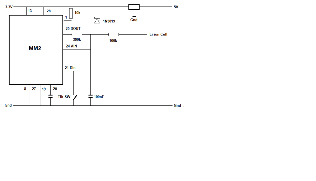

I have a project, where I need to count the pulses from a charger module, when the MM2 chip wakes up, which it does every five seconds. When the MM2 wakes up, it currently looks to see if a tilt-sensor is active. If it is, the normal code runs. If it is not, the MM2 goes back to sleep for another five seconds. This repeats forever. What I want to be able to do, is count the pulses from the charger module, when the MM2 wakes up, BUT - it must count in the correct place in the sequence, and must be able to work out the correct pulses vs just whatever the charger module is doing at the time the MM2 happens to wake up. The charger modules are these ones HERE, and the "Battery Status" LED is ground referenced, and the G+ output has the pulses on it that I want to monitor. The charger module outputs pulses based on the condition of the battery. 4 pulses - Battery good. 3 pulses - Battery OK. 2 pulses - Battery weak 1 pulse - Battery flat, recharge immediatley. Each of these sequences of pulses, is seperatted by a 1000mS delay. So, I need a way to first detect the 1000mS delay period, and THEN count the pulses on the pin. However, as the MM2 chip can wake at any point in this sequence, I need a way to sync the pulses from the charger module, to the MM2 count input pin. My very first thought was that upon waking, the MM2 should IGNORE what is going on on the count input pin, and WAIT till it gets NO PULSES for AT LEAST 500mS, then start counting, but the issue with that, is that as the MM2 can wake at any point in the pulse sequence from the charger module, waiting 500mS may still not work. Perhaps I need to count at least TWO sets of pulse sequences? Kinda scratching my head with this one, and how to approach WHEN I try to start counting the pulses, cos with the MM2 chip asleep, when it WAKES UP, the pulse sequence from the charger module can be literally ANYWHERE inside that pulse sequence, and it is doing my head in trying to think of how I sync the MM2 to the pulses when it wakes up and looks to count the pulses from the charger module. Anyone got any ideas? Smoke makes things work. When the smoke gets out, it stops! |

Hi Grogster, #1 why not keep the MM2 awake ? (*) #2 use a picaxe 08M2 to keep track real time #3 use hardware (counter + restart timer) (*) I cannot get (in Europe) the charger details (Ali blocks it) but when the G+ output is 3.3V logic, it could power (shottky diode, capacitor) the 08M2 or counter/timer, or maybe even the MM2, as well as supply the pulses. But I would look at a way to keep the MM2 alive, maybe in some state (low CPU speed, all IO stopped) so it uses minimal power. But the 08M2 is also a solution. You describe an alternative, where you wake up random, and start looking for the IWG (inter word gap). See the pulses as data (words), and the time in between 2 sequences is called the IWG. So you scan for X seconds without pulses, and start counting from there. But that IWG could be 2 seconds. So you would be awake 1 seconds of the 5 seconds. Still saving power, but not so much. Just make sure you detect the 1 second without pulses. Then you automatically skip being in the middle of a pulse train. Volhout Edited 2025-09-30 16:56 by Volhout PicomiteVGA PETSCII ROBOTS |

What is the timing of the pulses? Use the pulses to wake the micromite up. A micromite should wake fast enough to detect the trailing edge of the first pulse. Continue counting the pulses for the time-span of the 4 pulses. Process the count and go back to sleep. Every 5th wakeup, do the things you were previously doing at the 5 second wakeup. This relies on the battery system continuing to send its pulses. Jim VK7JH MMedit |

the device used seems to be an ETA9640, see: http://www.eta-semi.com/wp-content/uploads/2022/03/ETA9640_V1.5.pdf and: https://www.ebay.com/itm/203199357809 simplest solution: integrate the pulses at the LED's anode, using a relatively high value resistor and a largish capacitor. then measure the voltage across the capacitor with one of the MX170's analog inputs. you'll need to experiment with the component values to find what is optimal, and may need a blocking diode in series with the resistor (depending on if pin 7 is pulled low when the LED is off). cheers, rob :-) |

Hi everyone - thanks for the suggestions. @ Volhout: #1 - MM2 must sleep, as maximizing the battery life is what this project is all about. Leaving the MM2 running - even at CPU 5 for example, has a DRASTIC effect on the life of the battery. Sleeping the MM2, and only waking to check the tilt switch, and if inactive, go back to sleep, dramatically increases battery life before a recharge is needed. #2 - That's interesting! Never thought of that, but we'd have the same issue with the O8M2 running all the time, it will kill the battery much much faster, so although I like that idea, I can't do it that way either. I like the idea of using the WAKEUP concept and counting the pulses then going back to sleep. That is an idea I think I might play with on the test-bench. I'll also look up the counter chip and the cap idea by Rob - all worthy of further investigation. It's only tricky, cos I need to keep the MM2 asleep as much as possible, to maximize the battery life. Smoke makes things work. When the smoke gets out, it stops! |

Jim makes an important point, It can take up to 1mS to respond to the WAKEUP Pin. Synchronizing by timing alone has limitations as the main clock is stopped and the Wake Timer accuracy is ±20%. For a 5S interval, even if it starts perfectly synchronized, it would have to wake at least 1S early to be certain of catching a set of pulses, and stay awake till they arrived. Up to 1S if it just missed a set. Both of these accuracy problems could be reduced by first measuring the actual Wake Timer and WAKEUP Pin response time for that specific chip and saving with VAR SAVE or putting them in the code. The times could possibly be affected by temperature and supply voltage so that will need more testing. An external timer may be more accurate but also uses some power. Edited 2025-10-01 11:39 by phil99 |

Hey Grogster, I think the solution is easy, (well famous last words). Wake up at your 5s interval. Check for pulses, and start a loop after each pulse that counts 500ms (or suitable delay) if another pulse comes in that 500ms then start the loop again when you get a 500ms with no pulse then start your count on the next incoming pulse, if no pulse after 1000ms then battery is too low. What am I missing here? Regards, Mick (The big one) . Mick's uMite Stuff can be found >>> HERE (Kindly hosted by Dontronics) <<< |

binary counter and a monostable? The pulses go into the counter, the outputs of which go to GPIO pins. The monostable is triggered from the same pulse input as the counter input. It's output triggers the MM on its falling edge. The monostable has to be set to allow just a bit longer than the maximum number of pulses. The pulses start, the monostable output goes high. When the monostable output falls the MM wakes up and reads the count. Two CMOS chips aren't going to be much of a battery load. I think you are going to have to do something like this to make sure things stay in synch. You can't allow for the inaccuracy of the charger pulses being at 1s and the MM being at 5s as one of them is bound to drift even if it's accurate initially. The MM doesn't need to do anything with the count until it's official wake up period, just store it. . Edited 2025-10-01 17:44 by Mixtel90 Mick Zilog Inside! nascom.info for Nascom & Gemini |
TassyJim![]() Guru Joined: 07/08/2011 Location: AustraliaPosts: 6606 |
If you want to use an external counter, The 4040 12 bit binary counter would be ideal. Just keep counting over the 5 seconds between the present wake-up. If the 5sec is spot on, there will be 5, 10, 15 or 20 counts. If the 5 secs is fast there could be 4, 8, 12 or 16 counts and if the micromite is slow, you may get 6, 12, 18 or 24 counts. For the purpose, that will be sufficient to determine the battery state. 5 pins needed to read the counter and one to reset after the read. Jim VK7JH MMedit |
