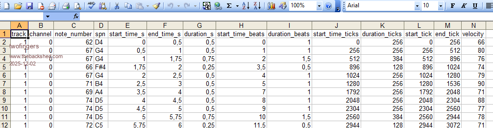

Do you envision writing a MIDI interpreter for the Pico?

  Quote  How can I use a microcomputer with an input to read 12 digitag signals (1/0) almost simultaneously?
For example, with serial parallel-to-serial shift registers such as the 74HC165 or an analog multiplexer such as the CD4051 or ...
Just ask the AI ...
I think you are more interested in the process than in the finished solution?
Michael
Edited 2025-11-03 02:36 by twofingers

Unless you are very much motivated to read the original tunes, here you can find a project that also has a link to MIDI files.
Starting from a MIDI file is a lot easier, since you have timing and note information available already.
DIY chimes
The ESP32 python code to decode midi file could be re-written in MMBasic. Or maybe something like this already exists for the MM2. ?
Edited 2025-11-03 20:27 by Volhout
