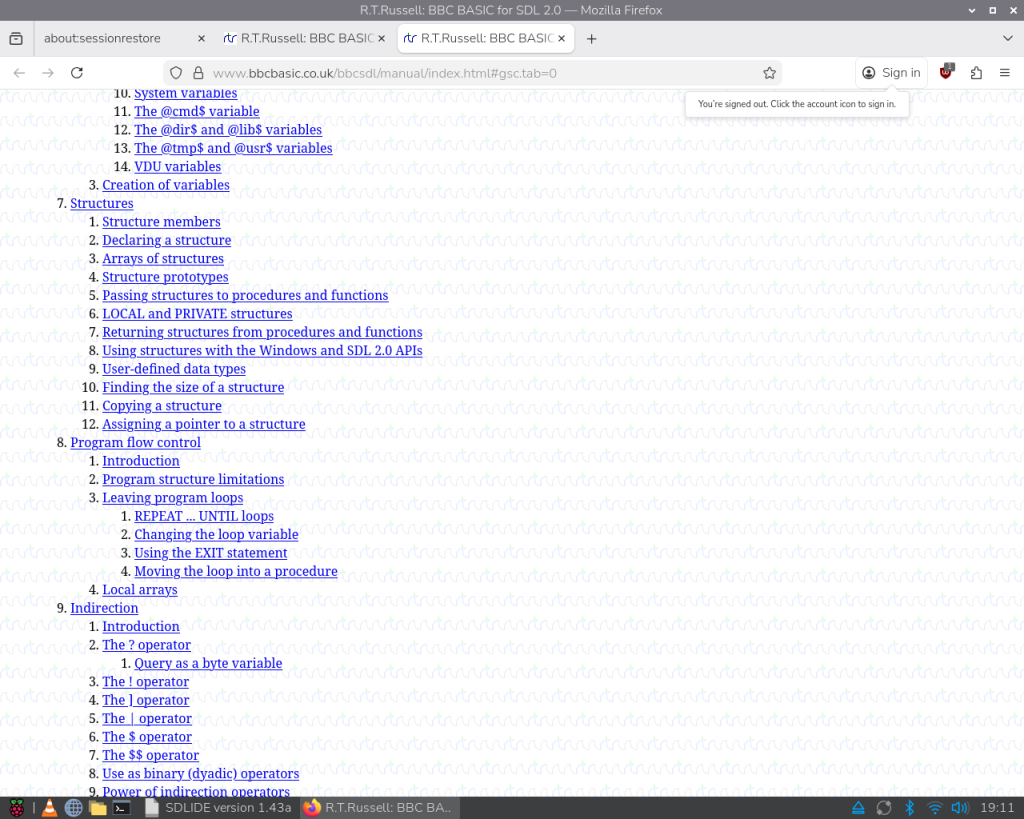

I looked up srtuctured coding/basic and the bbc basic I installed on rpi 400 has opengl and structures. Don't personally see the point but that's cos I don't know enough to say out.
