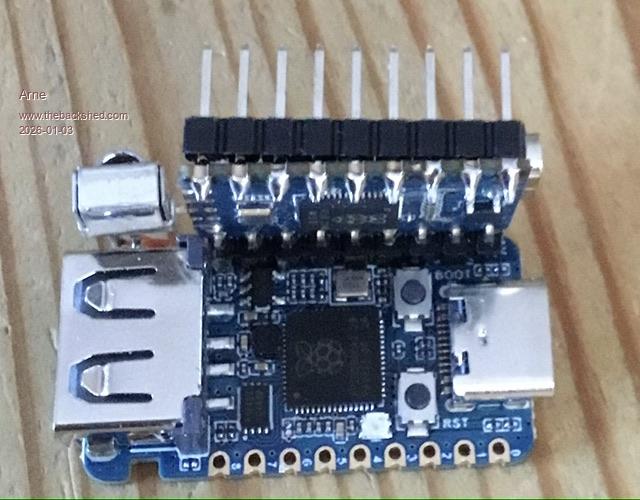

Hello  Bill,
You can use HID-Remapper on a second pico. It could be adapted/configured to your needs via browser and controlled by MMBasic thru the GPIOs. Here fotos of my actual prototype as IR-Controller.
I actual made some tests to use it as a multi remote control.
Without the second pico you can control the MMBasic editor e.g. with mouse or joystick etc.
See also my post „Picomite & HID-Remapper“.
Arne

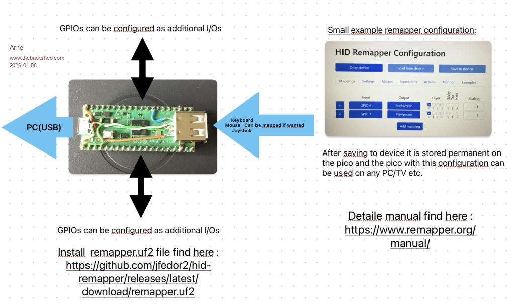

Hello Bill,
To do the things you wanted MMBasic is not needed.
Do it directly with HID-remapper:
- solder 4 lines to the pico (see also manual/picture)
- install remapper.uf2 on the pico (e.g.  rp2040 version)
- connect switches/LEDs etc. to the relevant GPIOs (e.g. to make your own controller)
- configure via browser
- save configuration permanent to pico
Thats it. The hardware can be used on PC/ Mac/Picomite etc.
Here a short overview to have an idea:
Have fun
