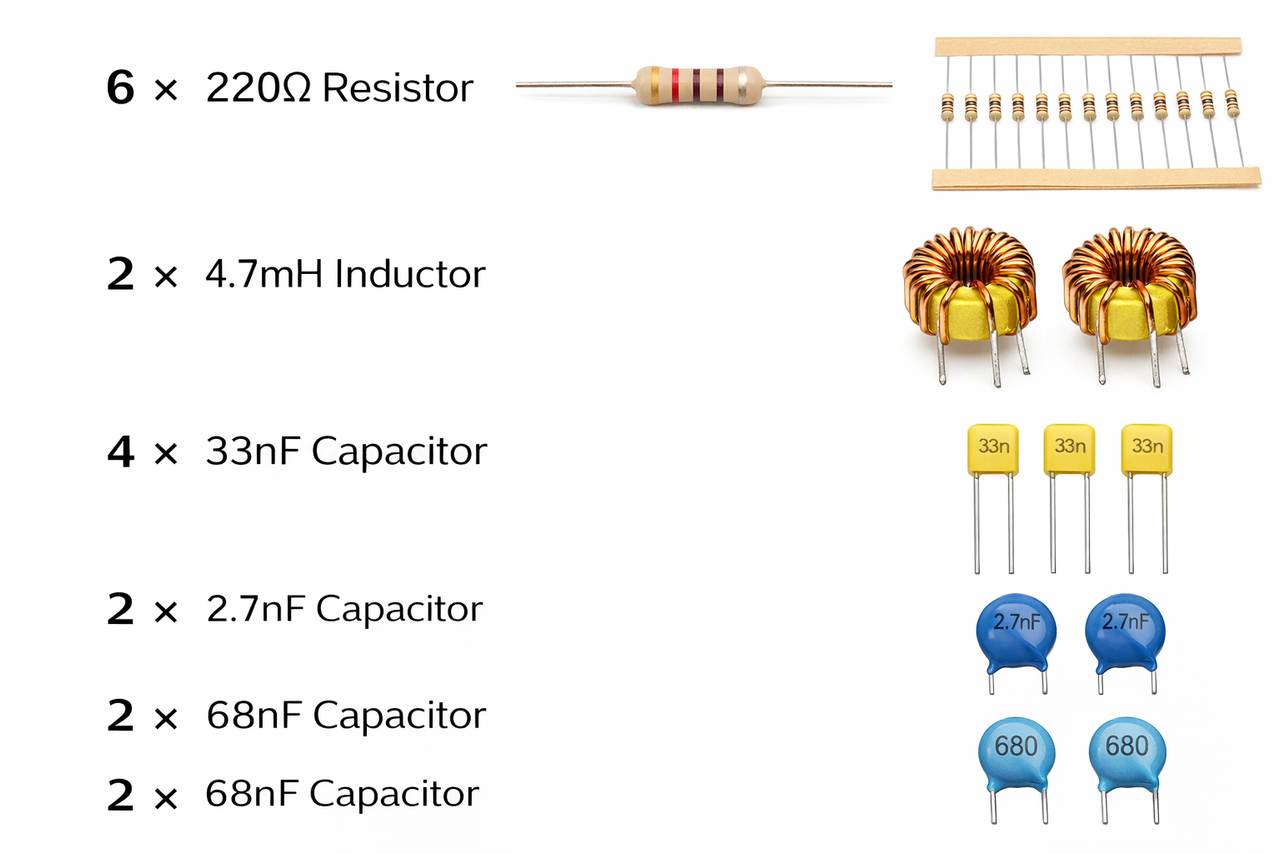

are this the correct parts voor the audio filter picomite

The colour code of the 220Ω resistors doesn't look right. I think you should measure them before installing, they might be 420Ω
3 band + tolerance type:-
For 220Ω 1% I would have expected red, red, brown for the resistance, a space then brown for 1%
4 band + tolerance type:-
For 220Ω 1% red, red, black, black for the resistance, a space then brown for 1%
Edit.
The resistors in the strip look different to the enlarged one. Perhaps they are 220Ω
Edited 2026-02-18 17:21 by phil99

That inductor is a power type. Try to find a smaller axial type. There's no current involved in this application. Mount the two inductors at right-angles to each other or space them apart. You don't want inductive coupling between them.

For left and right audio, you would not need that many.
2 x 220 ohm
2 x 68nf
2 x 33nf
2 x 2.7nf
2 x inductor 4.7mH
people have successfully used this part
4.7mH
