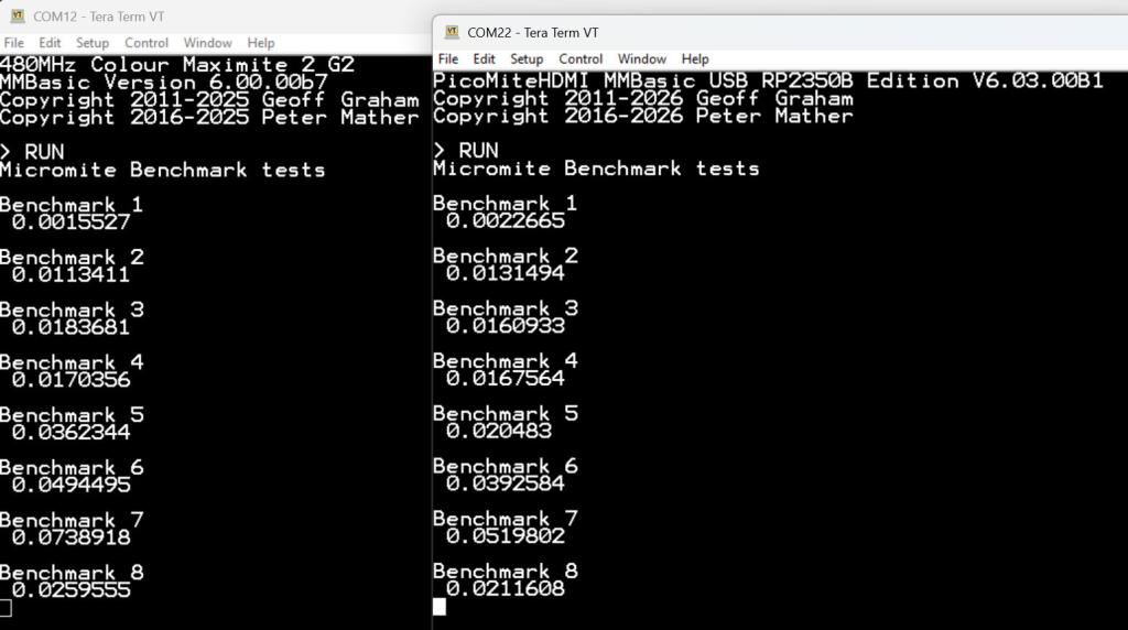

Option tracecache on 128
Pause 1000
Print "Micromite Benchmark tests"
Print " "
Print "Benchmark 1"
Timer = 0
For j = 1 To 10000
Next j
Print Timer / 10000
Print " "
Print "Benchmark 2"
Timer = 0
j =0
BM2:
j = j+1
If j < 10000 GoTo BM2
j=Timer
Print j / 10000
Print " "
Print "Benchmark 3"
Timer = 0
j = 0
BM3:
j = j+1
a = j/j*j+j-j
If j < 10000 GoTo BM3
j=Timer
Print j / 10000
Print " "
Print "Benchmark 4"
Timer = 0
j = 0
BM4:
j = j+1
a = j/2*3+4-5
If j < 10000 GoTo BM4
j=Timer
Print j / 10000
Print " "
Print "Benchmark 5"
Timer = 0
j = 0
BM5:
j = j+1
m = j/2*3+4-5
GoSub 4000
If j < 10000 GoTo BM5
j=Timer
Print j / 10000
Print " "
Print "Benchmark 6"
Timer = 0
j = 0
Dim rayx(5)
BM6:
j = j+1
m = j/2*3+4-5
GoSub 4000
For q = 1 To 5
Next q
If j < 10000 GoTo BM6
j=Timer
Print j / 10000
Print " "
Print "Benchmark 7"
Timer = 0
j = 0
Dim ray2(5)
BM7:
j = j+1
m = j/2*3+4-5
GoSub 4000
For q = 1 To 5
ray2(q) = m
Next q
If j < 10000 GoTo BM7
j=Timer
Print j / 10000
Print " "
Print "Benchmark 8"
Timer = 0
j = 0
BM8:
j = j+1
m = j^2
blog = Log(j)
csin = Sin(j)
If j < 10000 GoTo BM8
j=Timer
Print j / 10000
Loop While Inkey$=""
End
4000 Return
Here is the result with the PicoMite without the bytecode optimiser
  Quote  Benchmark 1
0.0022644
Benchmark 2
0.0180988
Benchmark 3
0.0288411
Benchmark 4
0.0262077
Benchmark 5
0.0738827
Benchmark 6
0.0926415
Benchmark 7
0.126989
Benchmark 8
0.0377242

Posts: 5927
Posted: 06:40pm 24 Apr 2026
Peter,
The first post shows cmm2 and non optimized pico results. What are pico optimized results.
Posts: 2991
Posted: 08:30pm 24 Apr 2026
  Volhout said  Peter,
Right hand screenshot is the optimised timings (as I read it!)

Posted: 03:25pm 27 Apr 2026
Peter,
Is this how you made the last 2040MIN version so much faster?
Posts: 11499
Posted: 05:54pm 27 Apr 2026
  Quote  Is this how you made the last 2040MIN version so much faster?
There are all sorts of tweaks which depending on the application will kick in or not.
If all goes to plan B3 will be the biggy and also probably as far as I can take it.
If B3 works it will massively reduce/eliminate scanning the through the code that currently absorbs quite a lot of CPU cycles.
PhenixRising
Joined: 07/11/2023
Posts: 1954
Posted: 07:12pm 27 Apr 2026
