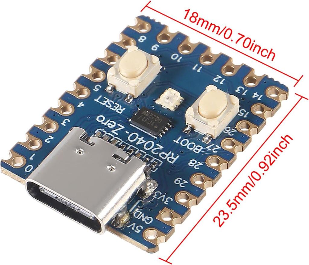

Amazon sells these little RP2040 boards for about $2 ($20 for ten).  USB C connector, boot and reset buttons and about an inch square.  I bought a few to play and use them with Arduino IDE but plan to use the real SDK.  Has anyone experimented with MMBasic on them?  I have a lot of little tasks in my lab where one of these running basic could be awesome.  It would be really cool if I could just plug in, use the USB console with editor etc and then set them to autorun.  A replacement for the old Picaxe!
Is there any reason that MMBasic won't run on one, I'm going to give it a shot but wanted to share, know others experience and any gotchas.
 Thanks.

Mmbasic runs fine on RP2040 zero.
I have several in measuremen instrumenta, and Mick uses one as fish tank controller.

Just remember that you have to treat it as a standard Pico though. You get the added bonus of GP29. Unfortunately the castellated connections are wasted unless you cut a hole or notch in the PCB.

A standard Pico uses the RP2040. The Pico 2 uses the RP2350. You can only run the RP2040 versions of MMBasic on the RP2040-Zero. I would still say that's reasonably exotic for such a cheap little module though. :)
As Lizby points out, there is also a RP2350-Zero which looks almost identical. That will obviously run the RP2350 versions of MMBasic, but not the HDMI versions.
Both of these modules, along with most cheap clones, use linear regulators - not the switchers that are on the Pico modules. This makes them even less attractive for battery powered systems unless you use an external switcher to power them at 3V3.
Note that the Zero boards don't have the facility to disable the on-board linear regulator. I have powered them at 3V3 though by leaving the 5V pin disconnected. Also, they don't have a diode from VUSB to the 5V pin so the USB input supply can't be isolated from your circuit. That can make things awkward sometimes.

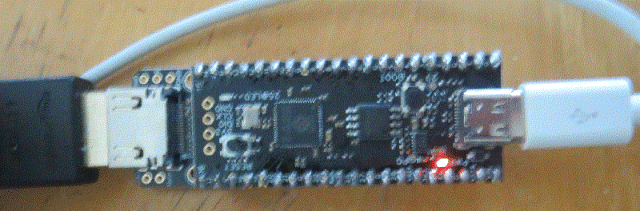

cosmic frog
Joined: 09/02/2012
Posts: 308
Posted: 10:56am 03 May 2026
  Quote   ...there is also a RP2350-Zero which looks almost identical. That will obviously run the RP2350 versions of MMBasic, but not the HDMI versions.
What is the reason the RP2350-Zero can't/won't do HDMI?
Thanks.
Dave.
Posts: 3291
Posted: 11:24am 03 May 2026
See the Video Output chapter. The HSTX peripheral used for DVI-D/HDMI uses a fixed set of pins, many of which are missing on that module.
On AE there are Pico 2 clones that use the same layout and pins as a R-Pi Pico 2 for a similar price to the RP2350-Zero so HDMI should work on them.

  phil99 said  ... HDMI should work on them.
Definitely (DVI, that is), and very convenient:
