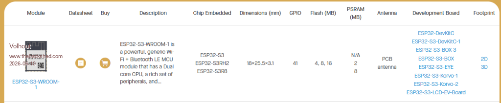

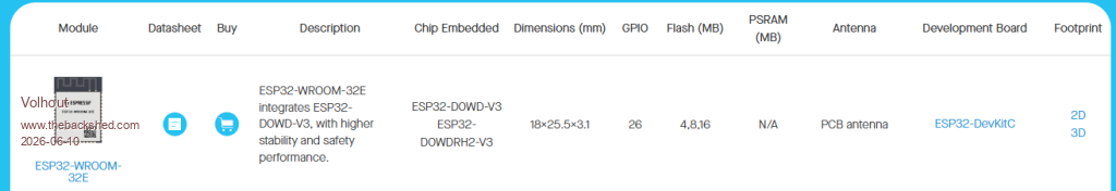

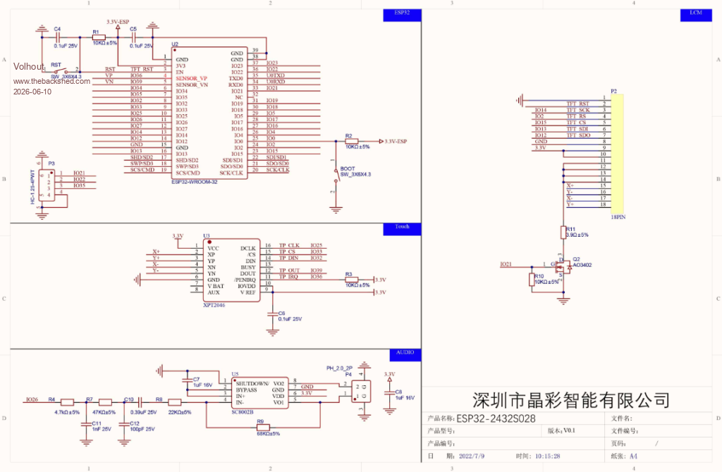

Hi Mick,
Not sure the S3 build will work on the CYD. The CYD uses a different chip.
The S3 chip has a different core.

The CYD I'm using only applies to the "ESP32-2432S028", not to the "ESP32-2432S028R" or other versions. It uses the minimal ESP32 module. Neither have anything like the capability of the S3.

The CYD (at least any normal variants) don't have the ESP32-S3 or any other version, only the normal ESP32. This is in spite of what some of the advertisers claim. There are other yellow boards with displays but they aren't the CYD.
Basically the CYD has a 2.8" display and only micro USB and a com port connector at the end. There is also a version that has an additional USB-C connector with them, but it has a slightly different display and is incompatible with some software. However, programs that are marked as compatible with CY2DUSB are ok. Annexe RDS can be used with either AFAIK as you set the display driver.
