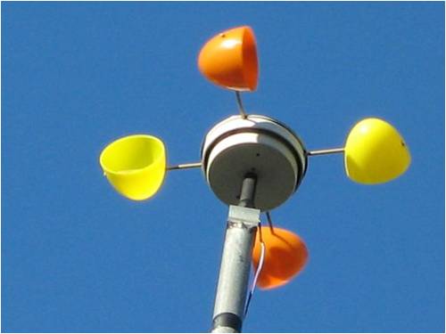

Heres a shot of my last one i built with easter egg moulds for cups.
Pete.

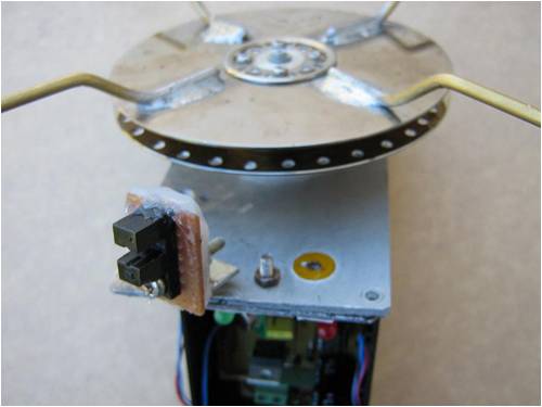

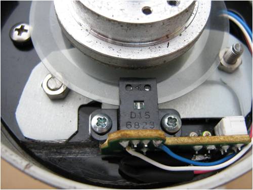

heres a photo of the internals showing the photo interupter used out of an old bubblejet printer.
You can see the amount of interrupts it has per rev. by the shaded area on the clear plastic disc being made up of interrupt lines.
Most systems with 1 or more targets (sensors) per rev. is next to useless in low wind speeds and as most bicycle computers only have 1 target per rev. I question what sort of reading they give in light winds.
Pete

Pete, looking at your anemometer cups I wonder if they survive the magpie landing on them test .
Also, why 4 cups and no three? Just about every anemometer I've seen has 3 rotating cups.

Photo interrupter, I like that. I can always put more magnets for the computer and compensate by cutting the circumference measurement in the computer by half. Double the sensors... however usually these computers are used to seeing far less sensor per rev, as cycling wheels RPM far less than I imagine an anemometer would.

Now you have seen a 4 cup aneometer.
Why 4 cups....Well i was lazy and routered a plastic disc out on the cnc router with a groove to locate the spokes in and rather then do the math for X&Y coords for 3 spokes i just went +&- coords on both X&Y and used 4 spokes.
The thing has never stopped spinning more than a few seconds, even when there is no breeze to be noticed.
As for the cups ...the $2.00 shop had a bag of 8 egg moulds out for $2.50 so i dont care if the break but doubt that they will as its a sturdy plastic.
I still have a spare set as well as the other half that is useable as well.

An earlier one i built used holes drilled into the HDD platter and a photo interupter, this gave me 33 holes per rev and i thought this was minimal for a decent reading as i had done one that had 6 targets and thought it was useless in less than a good wind.
The photo sensor needs to be turned around and adjusted.

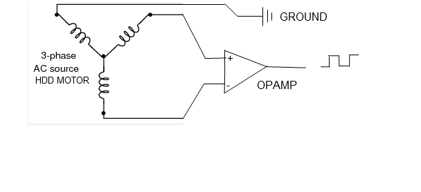

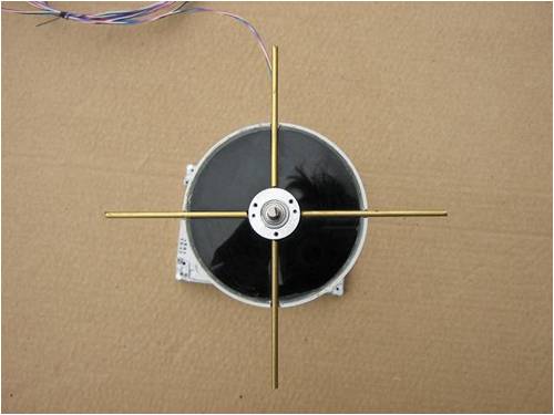

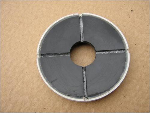

As there was a HDD motor on the bench from testing the HDD generator someone else asked about, i had a play at reading a pulse from the 3 phase motor.
With the use of a opamp i get a 4 pulse per rev square wave out.
There is a little drag caused by the magnet in the motor but this is marginal and think the HDD motor could be used as a pulse generator for an aneometer without modification.
This makes the project rather easy with limited construction and circuitry.
Any thoughts on what im missing here.
Pete.
