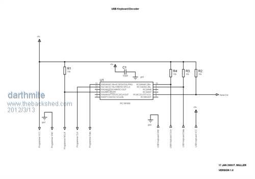

Hi ,
long time ago (2009)i do a little project to read a USB/PS2 keyboard and send the
ASCII code as serial.
It just use a simple little Pic 16F688
The header file is prepared for 3 different keyboard layout , actually it
was just the German layout active , The US and FR layout are just a copy/paste
from the German one. You then just have to put the right code under this sections
to be able to use the US and FR layout.
Read the comments at start from the *.c file to know how to use the other layout.
Here the Schematic :
2012-03-13_224251_16F688_USB_Keyboard_Decoder_schematic.zip
and the source code made with CCS C PIC compiler.
2012-03-13_223718_Keyboard_16F688.zip
I no more have this circuit at home for made the US and FR or other layout.
I hope it can help
This circuit is so small that you can directly integrate it into a KB and send
the serial data tough the PS2 cable
Cheer.

  vasi said   Tests must be done to see how fast you can switch without loosing the count. How fast is that chip? Is doing a multiplexing?
The 16F688 is 8Mhz , the serial is set to 9600 baud , when i have use it i don't
have loose any chars i pressed on the KB.
You will see in the source that the PIC only wait and translate the keyboard scan-code.
I don't have use interrupt , it's a pure bit banging system because every KB don't
send the bits at the same speed.
And about how fast it was , you can consider that it was exactly the speed of the KB
Cheers.
