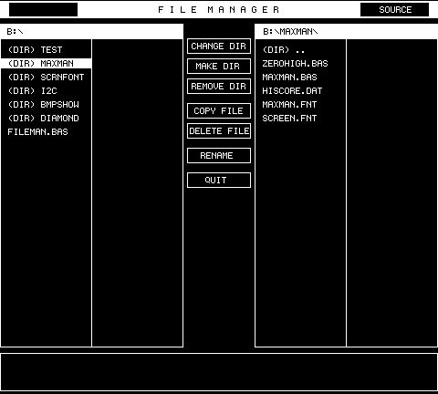

Here is a simple File Manager program I wrote that will allow you to organize your files on the SD card from the Maximite.
It's a dual window interface similar to Directory Opus on the Amiga.
It allows you to view 2 directory paths and copy files easily between them.
Usage:
UP and Down arrows move cursor up and down to make a selection.
RIGHT and LEFT move the Source window from left to right.
SPACEBAR tags and untags files
ENTER enters the Command Panel in the centre (Up/Down arrows to select)
ENTER again within the Command Panel executes selected command. (LEFT or RIGHT exits)
ESC cancels all tagged items.
Entering a blank (ENTER with no text) into a text fields skips that entry.
There is a display limit of 44 files and directories in each window.
Simple!
