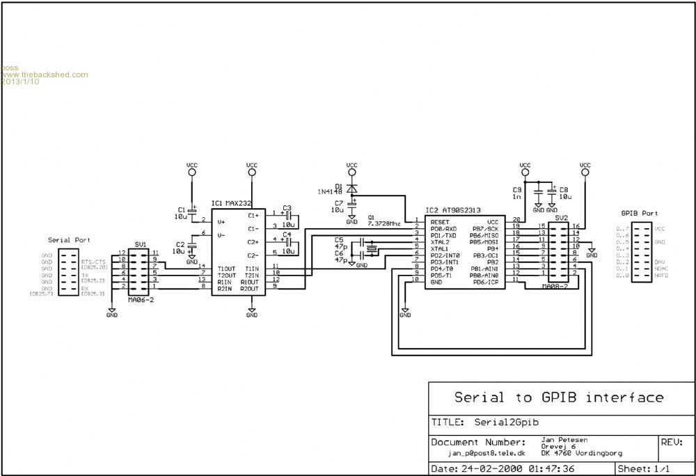

Joined: 19/08/2011
Posts: 268
Posted: 07:21pm 09 Jan 2013
Hi,
another $5 GPIB solution including BASIC source code. You can download trial version BASCOM compiler(code limit 4kB which is more then enough)
' (c) Jan Petersen
' Orevej 6
' DK 4760 Vordingborg
' jan_p@post8.tele.dk
' Date: 24.02.2000
' Compiler: Bascom AVR 1.0.8b
' File: Serial2Gpib.bas
' Description: RS232 to GPIB converter +
' HPGL to GDU converter
' This program is made specific for my Tektronix 4662 flatbed plotter
' with GPIB (IEE488) interface, and a strange GDU coordinate system..!
' Now it communicate whit a HPGL device-driver trough a normal
' RS 232 serialport. Hey man...
' Input:
' RS232 :19200N81R
' Handshake :RTS/CTS specific for (Eagle CAM processor)
' Output:
' GPIB :DATA[0..7] (Inverted !Activ Low!)
' Handshake :DAV (DataValid)
' Handshake :NDAC (NoDataAccepted)
' Handshake :NRFD (NotReadyForData)
' HPGL commands: Tektronix 4662 Plotter Commands:
' PU; (PenUp) M[cr]
' PD; (PenDown) D[cr]
' PA xxx,yyy; (PlotAbsolut) Dxxx,yyy[cr]
' VS xx; (VelocitySpeed) BYxx[cr]
' SP 0; (SelectPen) End Of File so goto home = M150,100[cr]
' GDU = GraphicDataUnit
' HPGL = HeweletPackardGraphicLanguage
' 1 GDU = 2.54 mm
' 1 HPGL unit = 0.025 mm
' 100 HPGL units = 1 GDU
' 1 HPGL units = 0.01 GDU
' All coordinates are divided by 100
' A typical input format would look like this (Eagle Cam processor-HPGL driver)
' IN; IP 0,0,100,100; SC 0,100,0,100;
' VS 120
' SP 2;
' PU;
' PA 19,18;
' PD;
' PA 1035,18;
' PU; SP 0; PA 0,0;
' Converted output to Tektronix plotter
' BY120
' M0.19,0.18
' D10.35,0.18
' M150.100

Ddrd = &B00010100
Config Portb = Output
Data_out Alias Portb 'Data byte to GPIB PortB
'RX PortD.0
'TX PortD.1
Rts_cts Alias Portd.2 'RTS/CTS handshake PortD.2
Dav Alias Portd.4 'DAV PortD.4
'NDAC PortD.5
'NRFD PortD.6
' Start --------------------------------------------
set dav 'No DataValid on GPIB port
Command = "M" 'set Command to MOVE
Gosub _reset 'reset variable
Reset Rts_cts 'uP ready

_gpib_out:
' Output data to GPIB port
' Data is inverted
' NRFS,NDAC and DAV is handshake
L = Len(result) 'how long is the string..?
For H = 1 To L 'loop the string
Low_ = "" 're use a old variable
Low_ = Mid(result , H , 1) 'pick out the character
Data_inv = 255 - Asc(low_) 'invert the character
Bitwait Pind.6 , Set 'wait until (NRFD) goes HIGH
Data_out = Data_inv 'Set the data on the port
Reset Dav 'DataValid on port
Bitwait Portd.6 , Reset 'wait until (NRFD) goes LOW
Bitwait Pind.5 , Set 'wait until (NDAC) goes HIGH
set dav 'Data NOT Valid on port
Bitwait Portd.5 , Reset 'wait until (NDAC) goes LOW
Next H
Return
