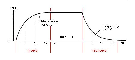

I havent `scoped' the signal.. but it would put a parabolic curved slope on the leading and falling edges Similar to this cct
A gate would sharpen the pulse of course BUT as the SPI input triggers are tied tied together and they are in the same chunk of silicon you can assume that they will all trigger at exactly the same level..
The proof is that the signals still appear to be pixel perfect in alignment on my screen in 80 column and mode 4 (40col??) modes. Maybe other will have a different experience than me.. Time will tell I suppose

Posts: 2552
Posted: 06:28am 07 Jun 2013
  Quote  A gate would sharpen the pulse of course BUT as the SPI input triggers are tied tied together and they are in the same chunk of silicon you can assume that they will all trigger at exactly the same level..
that might be a big hope, i'd certainly not be betting any money on it. in any production solution i'd certainly be adding in a schmitt trigger to ensure a sharp edge. a NC7WZ17 would do the trick nicely, smd in a 6-pin package, part of the 'TinyLogic' family.Edited by robert.rozee 2013-06-08
Posts: 3368
Posted: 03:00pm 07 Jun 2013
The inputs that we are talking about already have schmitt trigger circuits on the PIC32 silicon. In fact most PIC32 inputs use schmitt trigger circuits.
Posts: 2552
Posted: 06:46pm 07 Jun 2013
yep, but they can still have small differences in input capacitance + series resistance, and internal delays. with a vga dot clock rate these may become relevant. the use of an external schmitt trigger gate is to ensure that the rising pulse delayed by the external RC becomes a single clean pulse, which then removes the internal variations of the three inputs from the equation.
it could be that the three inputs are close enough matched that today there isn't an issue, while next weeks revision of the silicon is just slightly different enough for it to become relevant. i've worked in a company where much the same as this happened - a switch to an identical second-source of a device caused the problem - and we ended up having to bring back many millions of dollars worth of product from the field.
