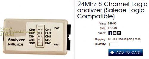

I could not ignore this price and the size,the price paid by White Wizzard is already very good.
I have recently purchased this unit for the indicated price from Kalex. It came with USB cable and thin colored cables with sockets both ends, no software. A 16 channel unit is also available. I downloaded the Demo? software from the Saleae web site and it is recognized and works, though not genuine Saleae unit. There are several similar units on the web. The unit consists of a 24 MHz crystal, a CY7C68013A-56 Cypress USB/Micro/Fifo, a 24C02N I2C EEProm, a LC245A 8 bit buffer and a ML6206A 3.3 volt regulator. It could be that Cypress has promoted a logic analyser application for this chip which seems to fit this application admirably?

The new Saleaes look pretty good, they will not replace a good scope because they are too slow on the analogue part but for many things (sensors etc) they will be great, I will probably get one (I've had a Logic 8 for a couple of years, fantastic product).
But if you need a scope you need a scope, personally I reckon most people working with embedded processors should have both.
@Kieth, I see the "Saleae" part of the label has been cut off, that was a but rud eof them I think to actually use the Saleae name on their clone.
BTW that Hantek is nowhere near as sensitive as a Rigol, 2mV/div verses 500uV/div, but then it is half the price.Edited by graynomad 2014-04-10

I got one of these yesterday. It has the name Saleae on the front. If it's a clone then it's a bit cheeky but as Keith said, it's hard to ignore the price of AU$20.

thanks a lot for the hint to the analyzers. I bought a compatible one in Germany for 15€ and it works very well!
This device is a great help for me!
