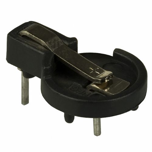

Ok.. After some looking around, I think I have made a decision... Since we want to use a socket for the battery, I think I will go with a 10mm cell instead of 20 mm...
Also, I have picked out a socket (Digi-Key PN BH401-ND) that is unique in the fact that it has a .1 inch stand off height above the board.. This space can be used to tuck the RTC chip and x-tal underneath the socket, saving space on the board... (sweet)...
2014-05-18_180526_CR1025_10mm_Battery_Holder_BH401-datasheet .pdf
Let me know if you guys think something is wrong with the thinking here..

Posted: 08:21am 18 May 2014
Also a real photo helps...
Elvish name: Mablung Miriel
Beyound Arduino Lang
vasi
Joined: 23/03/2007
Location: Romania
Posts: 1697
Posted: 08:23am 18 May 2014
As it is, it is in permanent short circuit without battery... you have to take care at the design...Edited by vasi 2014-05-19
