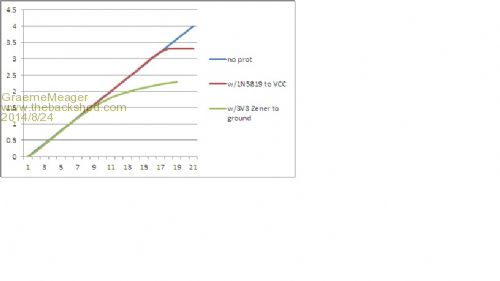

Mick & other interested TBSers I did some quick testing with overvoltage protection on the micromite. Set a PWM output into a diode and 100n cap to generate a variable voltage and then read it via a 1k resistor on an analog input with no overvoltage protection, 3V3 zener to ground and 1N5819 to +3V3. Here is the code: SetPin 26,dout
SetPin 24,ain Pause 100 For f=20 To 1000 Step 10 Print f;","; PWM 2,f,50 Pause 1000 Print Pin(24) If Pin(24)>2.99 Then End Pause 200 PWM 2,stop Next f Here are the results:
As you can see both types of overvoltage protection alter the way hat the analog inputs see the voltage. Any thoughts? GM |

Hi Graeme, That is very interesting... I wonder if it is something to do with the PWM.. As it is really a bunch of 3v3 pulses and not really a stable voltage, a 100nf cap is not a great smoothing device.. I think it might look a lot better with a larger (try 1uf) cap... This is all a learning exercise for me but my tests, which were for my MuP-Security project showed NO difference between the readings of resistor divider networks (I set up a 1/3, 2/3 and 3/3 using 3 x 4k7 resistors... in all scenarios the reading was within .01v of my calculations which is in the range of `didn't matter to me' and `from memory' all the readings were the same with and without the 1N5819's but then I wasn't looking for 0.01v differences. Try a larger cap and see what the differences are.. Regards, Mick Mick's uMite Stuff can be found >>> HERE (Kindly hosted by Dontronics) <<< |
| OA47 Guru Joined: 11/04/2012 Location: AustraliaPosts: 1050 |
Mick, I hear what your saying but the green curve which is smooth is using the same diode and cap. |

Graeme, Just conjecture on my part but what I suspect could be happening is a crude form of a diode voltage doubling circuit see This link ... Using diodes and capacitors It is possible to multiply the ac voltage many times.. Now we are not seeing a voltage double but it could be doing some thing similar.... I would like to see your results without your dioade and a resistor instead say 1k for a start.. Mick. PS. It obviously shows that the protection diodes CAN have some effect on the analog input.. I dont think you would see that problem with clean analog signals.. An interesting conundrum M. Mick's uMite Stuff can be found >>> HERE (Kindly hosted by Dontronics) <<< |
Mick and others, To avoid the diode doubling issue, I did the test by stepping a variable power supply and the results are in line with Micks findings and recommendations.
Thankyou for clearing up my confusion. GM |

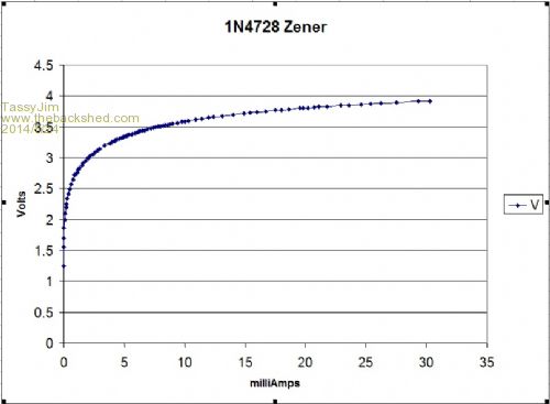

Are you sure you have the Zener the right way around? The red trace looks like the forward voltage drop. Jim VK7JH MMedit |
