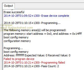

PICkit3 and IPE - it won't program either the original VT100 with bootloader, or the upgrade hex files - keeps moaning about an address being unexpected.
Here is the image:
The odd thing about this, is that it moans about address ffffffff - expected a 0, received a 0.
What the hell does that mean?
It expected a zero, got a zero, but that is still wrong?

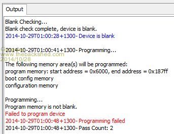

It's also moaning that the device is not blank, but if you look at the image I posted above, I did a full erase on it, and that completed fine. So, erase device, and that completes sucessfully - device is blank. Attempt to program it, and IPE says device is not blank - WTF?
EDIT: I can read the device fine - this completes without any error, but I can't program it.
ANother image:
I don't get this - I can read the chip, erase the chip, but it won't let me program it..... Edited by Grogster 2014-10-29

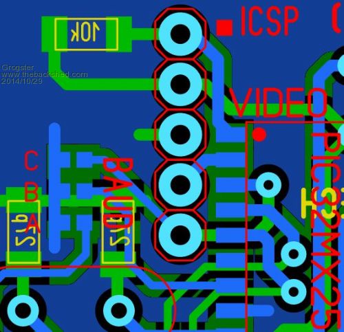

Here is a shot of the ICSP area of the PCB:
Note that although pin3 is connected to both the ICSP and the BAUD solder-blob pads, there is no blobs on any of the baud pads - all three are open-circuit, as I planned to set the baud-rate using the menu. I also changed the 10k pull-up to pin1 for a 4k7, as I note that Geoff's schematic calls for a 4k7, but that made no difference at all.Edited by Grogster 2014-10-30

FIXED IT!!!
I replaced the PIC32, but was getting exactly the same errors, so that made me think there MUST be a PCB layout error somewhere, so I studied the PCB layout, and found that the ground side of Vcap was not grounded. It WAS connected to the ground-plane, but that area of the ground-plane was electrically isolated from the rest of the ground-plane due to routing of tracks. I soldered a little link between the ground side of Vcap and the nearest ground reference point, and low and behold - I could program the device!
It's all up and running.
