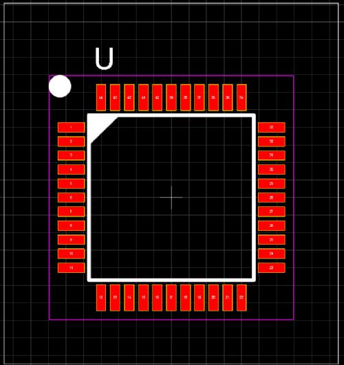

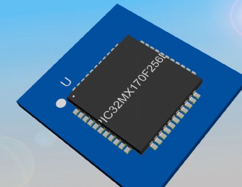

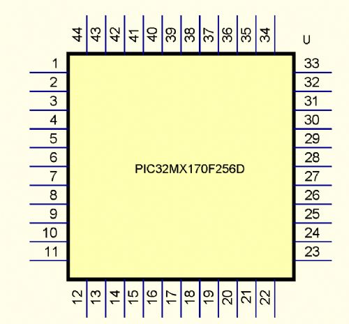

Hi All,
I know there are a few other users of Autotrax DEX out there and maybe are as frustrated as me with some of the included components.
I also lost a few parts I created myself when I had a HDD crash a few months back.
So I have started this thread to offer my designs to other users out there and welcome additions back here as well.
I redesigned these parts as they either did not exist or the ones supplied didnt suit my requirements.
NOTE!! Some components in this list could do with some improvements/enhancements but at least they are a start and can be easilly editted.
A couple of parts are NOT MINE and are ones I copied out of the existing library.
The list includes
10214-6212PC.part
1N4728 mik.part
2x3 solder short pads .part
3x2 solder short pads.part
8Pin-DIP-SMD.part
BC337.part
DB25F-Solder.part
DB25F.part
DIP8 Mik.part
Header mik DIL 6.part
LED-Mik.part
Mini DIN 6.part
Mini USB Through Hole.part
PIC32MX150.part
PIC32MX170-SSOP.part
PIC32MX170F256-QFN.part
PIC32MX170F256-SSOP.part
PIC32MX250 .part
RCA R-A.part
Rotary 16p.part
Screw Jack 2 Pole.part
Screw Jack 4 Pole.part
SIP 2 - Mik.part
SIP 5 - Mik.part
SIP 6 - Mik.part
SIP 8 - Mik.part
SIP Header 10 mik.part
SIP Header 14 mik.part
SIP Header 16 mik.part
SIP Header 2 mik.part
SIP Header 3 mik.part
SIP Header 4 mik.part
SIP Header 8 SMD mik.part
TRIMPOT mik.part
VGA F.part
